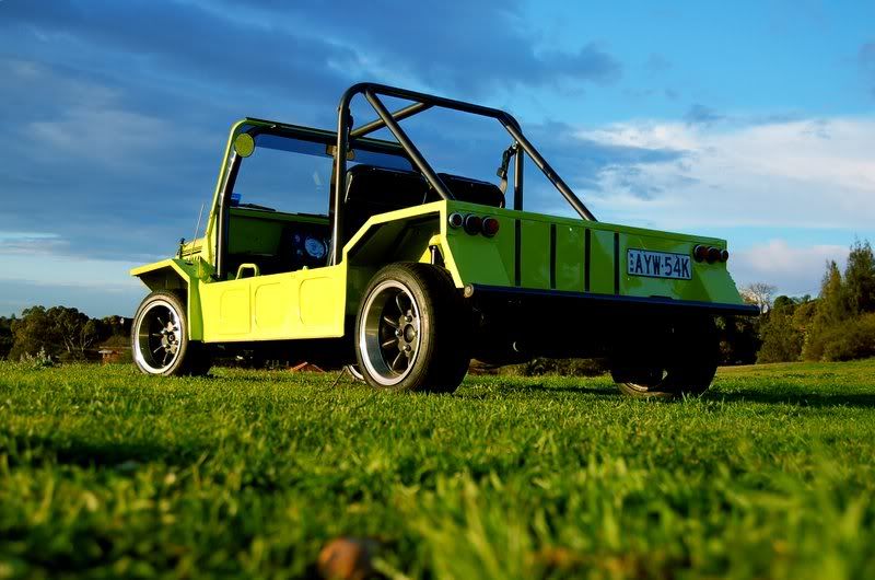

I'm not a fan of 13x7's apart from looks perspective (hey we run them on the moke). IMO they are too wide for a mini, increase torque steer in high powered cars and tramline under brakes and over bumps not to mention the massive stresses on wheel bearings..
