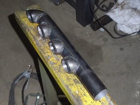

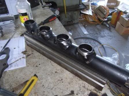

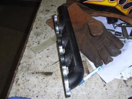

I had the pipe machined out so it was time to put it all together. I set it up and gave it a quick tack with the MIG. I used the laser cut flange to get it in the right spot.
Then got dad to give it a shot with the TIG.

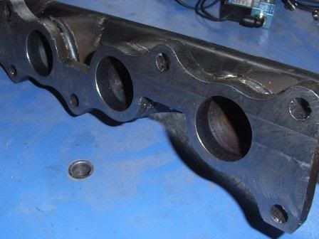

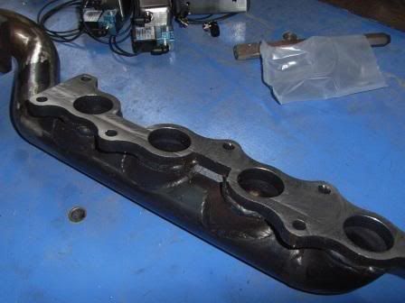

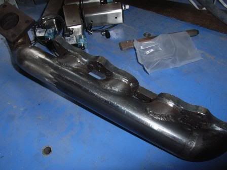

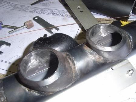

Came up great! Only thing was the heat we had put into we had banana-ed it a fair bit, so while it was hot we chucked it in the press and bent it back a bit, then with a bit of shrinking were able to get it straight enough for what we need. Once it had cooled down, I got into grinding out the runners so they had nice smooth entries. Don't know if you can tell from the pic.
Then i put it back in the mill and decked the runners so i could but up the flange. Gave it a little tack and presto!

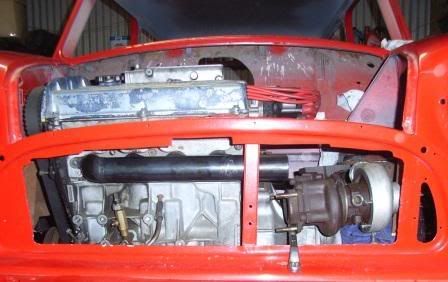

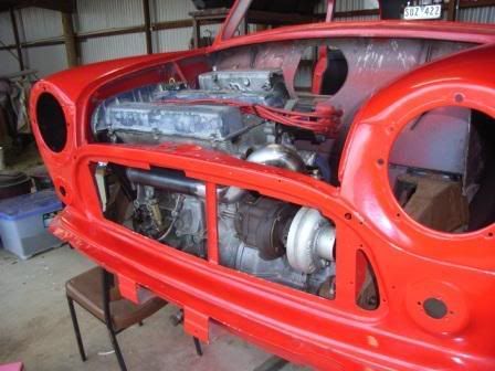

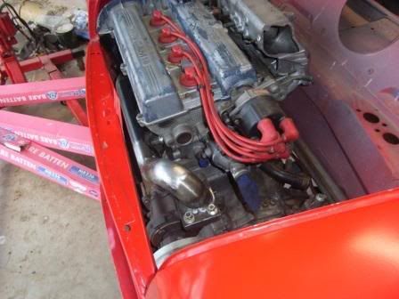

Came time to fit it up. Because we haven't welded up the flange yet, it was still pretty straight and fit really well. Had great clearance with the front grill and the support bracket. Now i have to work out exactly what i want to do with the turbo. I think i'll go here. I can cut the log off about 100mm earlier, this means i can make up a reasonably nice flowing join to the turbo. Hopefully have another update soon with the turbo mounted in place.
PostPosted: Wed Aug 29, 2007 1:11 pm
looks fantastic - can definitely see the flow work on the entries

Take it easy when welding that flange on as it will bannana too.
I welded flange on from the inside then decked it to get a flat surface, it came up alright.

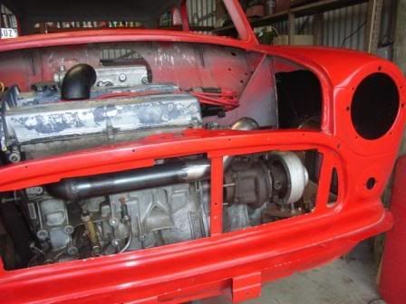

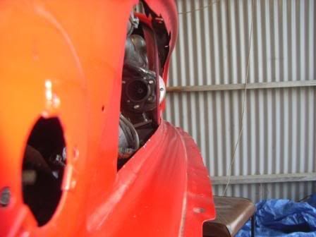

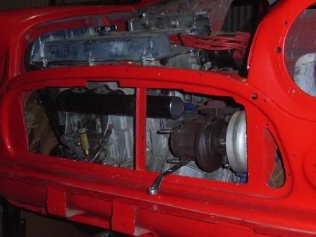

Just a quick one. Welded up a bit more of the manifold to get it in pretty much the right position. Originally i had 3 90's basically butting up against each other but looked like some really tight bends so i made it with some 45's and a little straight as well. I might have to heat it up a bit and pull it away from the front grill just a tiny bit. I've got plenty of room to keep the cable clutch and it should miss the thermostat/outlet for the coolant so i'm pretty stoked. Just have to start making up the dump now and try and find a nice place for a radiator and intercooler.

Nice work. Maybe you could just put a couple of plastic spacers under the grill? :idea:
PostPosted: Sat Sep 08, 2007 4:51 pm
The Forkmeister
Posts: 1029
Location: camden
Nice work mate, should be a missile once it's finished... :D

Hopefully it doesn't explode though... :D
Yeah i thought about spacing the grill, just to get a bit more space but then read somewhere about an absolute grilling a guy got on here about doing that :) I've got plenty of space... and hopefully i can bend it back enough. I think also i need 10mm between the engine and the body so i'm gonna have to do something.

Ok, Uni has been a bit full on so i haven't had much of a chance to get onto the mini. Finished welding up the manifold which looks great, and machined the face that sits on the head, bought a new gasket so i cant wait to put it on. I just have to machine the turbo flange, clean up the welds and make it look nice. Not sure whether i'm going to coat it or not. What are everybodies thoughts, is it worth the money?

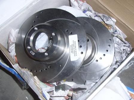

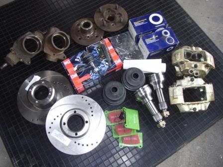

And on the subject of money, i lashed out and bought some rotors that just came today :D . I think i pretty much have everything i need to put these bad boys together. A word of warning to anyone that wants brakes, by the time you stuff around buying bits here and there, you might as well just go out and buy a set already put together from a mini specialist. I have spent way tooooo much money on this set. It better work!!!Actually, I was going to buy new studs, are they any different to mini disc brake studs? On the second pic there is a wire coming out of the Green Stuff Pads, is that just an optional sensor? Can i take it out?
So i've also bought some brake caliper paint, i think there is something about the heat that bonds to a hard finish. Can i use this on my hubs and drive flanges? If not, what should i be using? Can i just mask up the insides where the pistons and seals are and then just spray at will. I've got little plugs in all the holes so it should be right yeah?

You have the best looking log style manifold I've ever seen 8)
