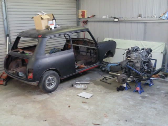

Will upload some more of it tomorrow after I get them off my camera and onto photobucket

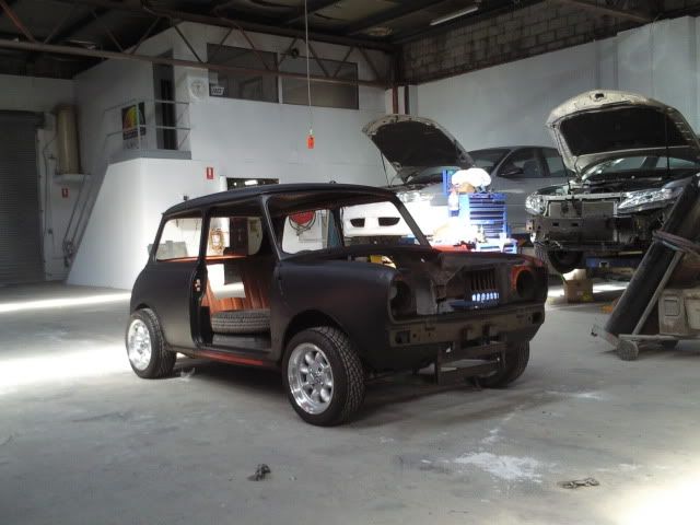

Is now under black etch primer and been cleaning up the welds on the firewall.

yep sure is. It's one of my long term projects. Good eye.
The wheels are just sitting under it to see what it looked like. I loved it.

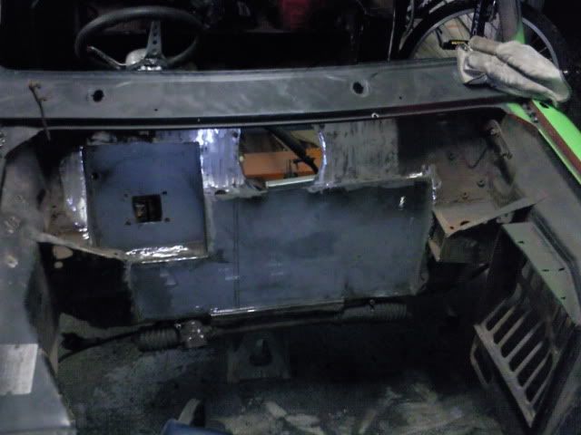

Are you doing any re-enforcing of the firewall?

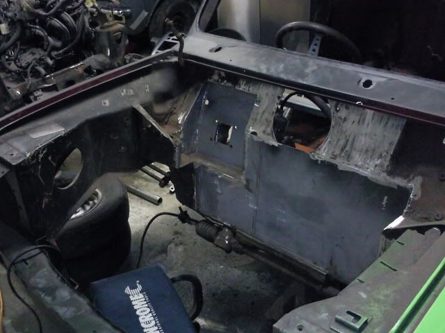

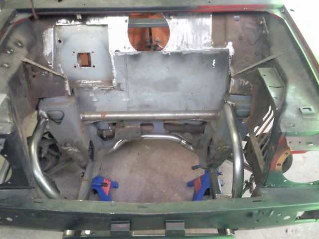

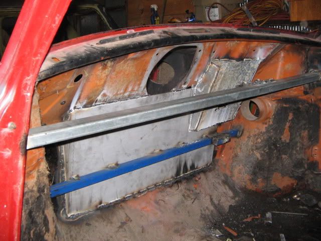

The inside of the firewall has been reinforced and the new firewall itself is thicker steel than the original. Had an engineer look at it and says all will be good when finished so fingers crossed. Hoping to have it done for Minifest in Hobart in November.
As for the Hillman I have an Alfa Romeo twin cam 1800 complete car that will be stripped of all its running gear and fitted to it. A set of 18" chrome wheels and as low as in the photo. Haven't picked a colour yet(keep changing my mind) but the Mini will most likely be bright green pearl.
Thanks for all your encouragement so far. Makes me want to get more done to it.
This is just some of the internal bracing for the firewall. Have done a bit more since photo was taken.

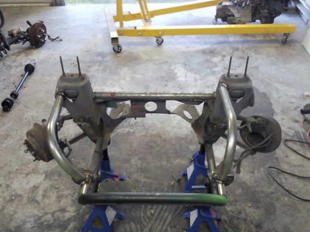

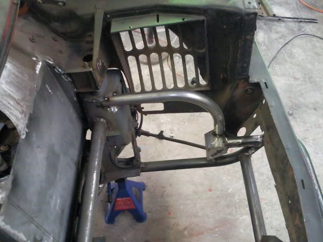

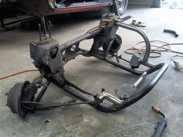

Well I've been working on it most of the weekend and have nearly finished the subframe and am very happy with the way it is looking now.
Here are some pics.

mmm YUM looks very nice :D

Yep... lovely!
Nice tube work - looks very neat.

Thanks guys. I measured up what I wanted the tube to look like and got the local sheet metal place to bend it up for me. I'm hoping to get my own roll bar tube bender soon though so I can do it for myself next time and also bend up my own cage for it.

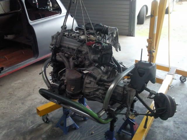

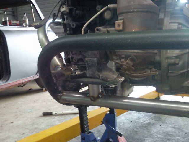

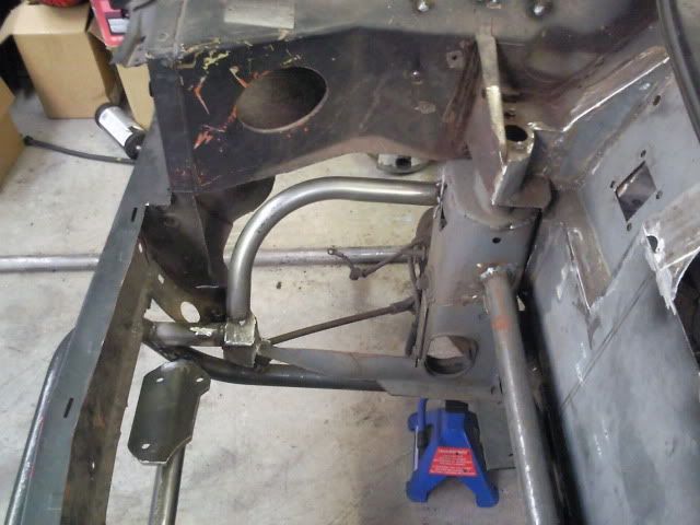

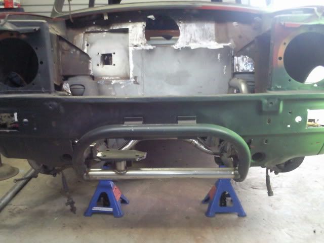

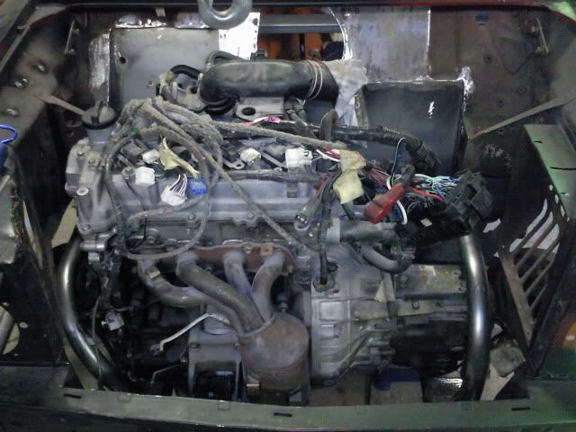

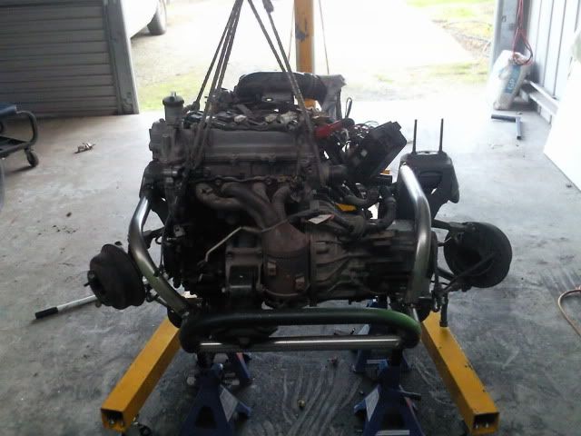

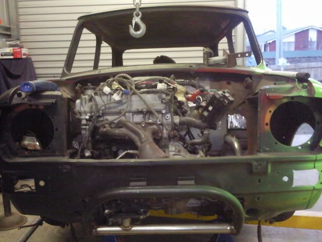

Well back at it again this week. Went to fit the subframe in today but had extended the pipework too far forward so wouldn't actually fit. OOPS :roll: Anyway decided to remove the top pipes and move them back as shown in the photos. Now I've refitted them in a better position and Bolted it up into the car and trial fitted the engine.
Here are some new pics.
I think that will be enough for today.
I've also started trial fitting the shifter rods and the exhaust. I have to shorten the shifter rods about 100mm (tried 50mm today but still too long) to fit in the original position
Phil

I like the idea of the nudge bar being part of the subframe.
