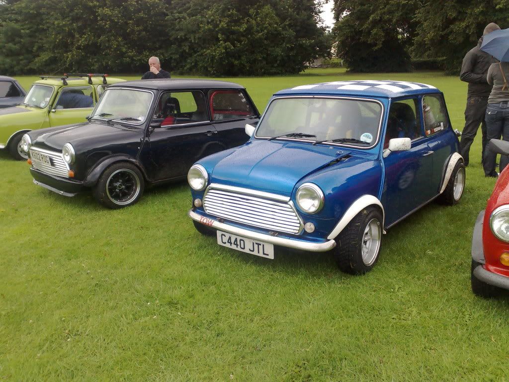

Following on from the vent discussion.
This is an interesting discussion about raising the rear edge of the bonnet to create cooling.
http://www.theminiforum.co.uk/forums/to ... d-bonnets/
So the same principles would apply for expelling how you want to. I'm sure you could come up with an actuator set up that you could open and close while on the fly. Which brings me to...
Another idea to throw in to the mix is an air scoop which is manually activated by a cable, like the Ram Charger/Airgrabber set ups on Mopars. These were used for bringing cold air in, but no reason the principle couldn't be applied to expelling air as well.
https://moparconnectionmagazine.com/the ... induction/
And a few other ideas to throw in to the mix

The last one looks good. The mini bonnet is not quite as long though.
