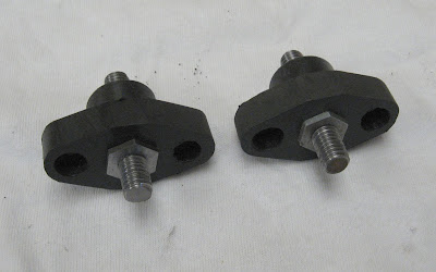

After the feedback about ground loops, I've made a second through-panel connector so that the ground cable is not attached to the boot floor.
I've drilled a hole near the factory battery ground point and the negative post of the battery will join to this new connector. I'll extend the ground cable under the car (using a butt connector and some spare cable) and route it around the battery box to fit to the new connector under the boot floor
-Alan
