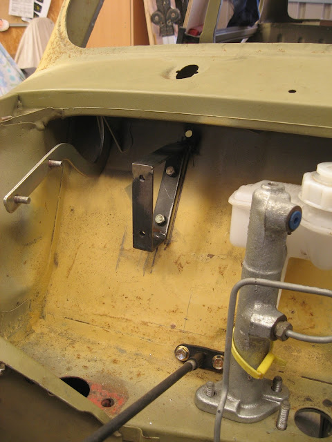

The last few engine bay parts have been fitted : coil/ignitor assembly and windscreen washer bottle. The coil/ignitor assembly was bolted to the bulkhead (it has to be electrically grounded). I got a new HT Coil ignition lead custom made to suit the length required
I removed the engine at this point so I could sort out some other items including the washer bottle. It was a generic one from eBay that (just) fitted above the drivers side subframe tower. After measuring and ordering an appropriate size bottle, I put on on some wood pieces and fitted the bonnet to make sure clearances were ok
I made a small bracket from some flat bar onto which the bottle slides onto

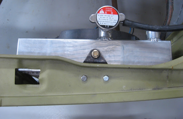

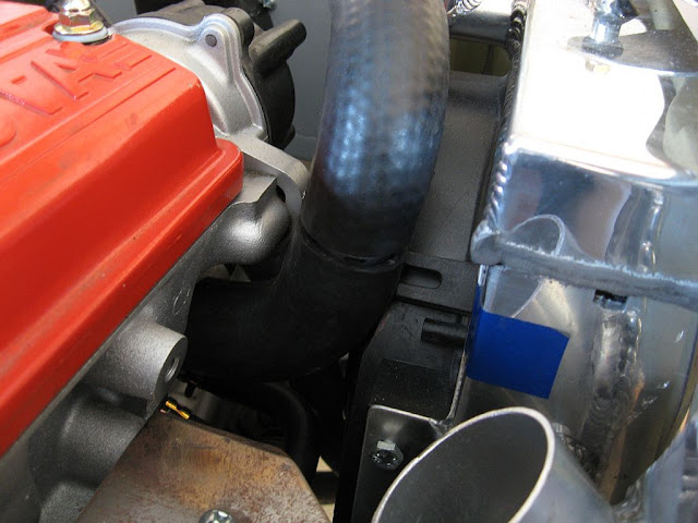

A clearance issue that has been on my to-do list for some time was between the radiator thermofan (bolted to the back of the radiator) and the radiator hose at the thermostat housing. Despite me using a radiator hose piece with a tight bend at the thermostat housing outlet and trimming back a small part of the thermofan cover, the hose was still fouling against the plastic thermofan cover behind the radiator. The hose was not squashed at all, it was just touching it but with engine movement over time this would probably rub a hole through the hose.
I really wanted there to be a reasonable physical gap between the hose & thermofan cover and to achieve this I had to lean the top of the radiator forward further. I cut away some more of the front panel (I had done this already but not enough) and welded on a new steel strip to retain the original 90degree angle in the panel and giving it back some rigidity
After making a new upper radiator mount, I achieved an extra ~13mm which should be enough for the hose clearance but I won't know for sure until the engine is back in. Of course I couldn't go too far forward otherwise the bonnet latch would not fit

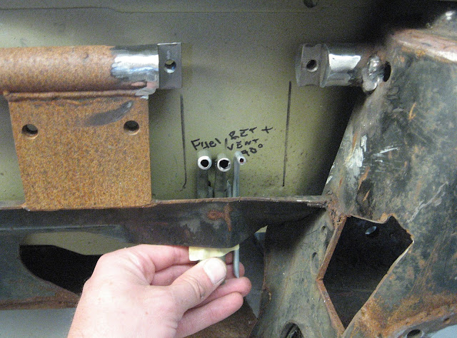

The fuel lines will be the next task for me but before that, I figured out a route for the fuel lines (feed, return & vent) within the engine bay. I decided that the steel lines that would run under the car had to stop half way up the firewall and have a bend formed at the end of each of the lines to clamp some rubber lines onto.
The problem with ending the fuel lines there on the firewall is that the brace bar between the front subframe towers would hit the fuel lines when I try and fit or drop the subframe.
I had the idea to make a small part of the subframe brace removable by making some roll cage joiners. I borrowed use of a mill and milled some 30mm rod
These pieces were machined down to size and drilled/tapped for a M8 bolt
and then welded in place
Now when fitting or removing the subframe, the small length of the brace can be temporarily removed and the fuel lines can stay in situ.
Have you thought about using uprated but maybe smaller OD hoses? (making sure the water pump and flow is as required...)
https://www.summitracing.com/int/search ... s-radiator
The engine goes back in soon at which point I will be able to confirm how much of a difference the radiator angle change has made. I also plan on making a retaining bracket (maybe like a big P-clip?) to hold the radiator hose close to the engine and away from the thermofan shroud to gain even more clearance. If it's still an issue, I may have to consider something like a smaller OD hose.
