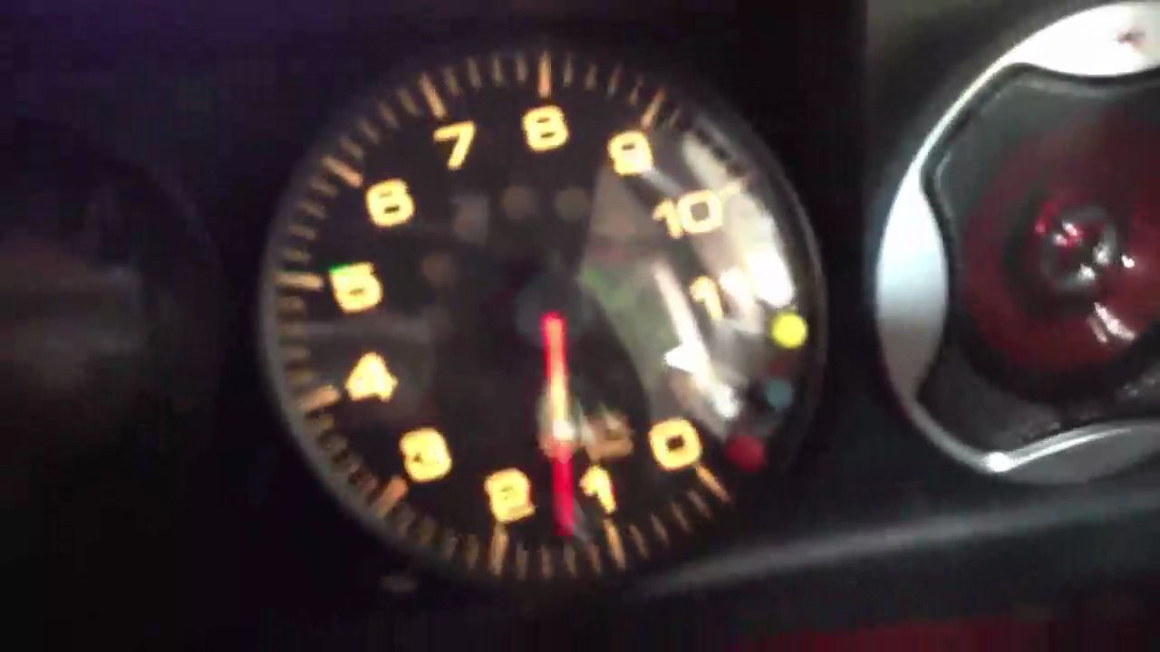

They're called spek pro gauges, usually used in NASCAR as they have peak warnings and log data sneakily
I also like them because they do this sort of thing

PostPosted: Thu Jan 10, 2013 9:32 pm
Posts: 10654
What are the lights showing? Tricky to see in the vid.
:D
PostPosted: Thu Jan 10, 2013 10:14 pm
Yes, a bit confusing . Are they shift lights?
PostPosted: Thu Jan 10, 2013 11:07 pm
Posts: 4682
Location: sunbury victoria
Yeah I had them set too close together, it has a pit road rpm thing on it which you can set to turn green at say 1100rpm, then when it gets to 1100.1 rpm it turns red, also you can set the shift lights which are staged in the centre of the gauge so 12345 lights and then the gauge turns red at peak rpm.. That was just thrown in and set too low and close

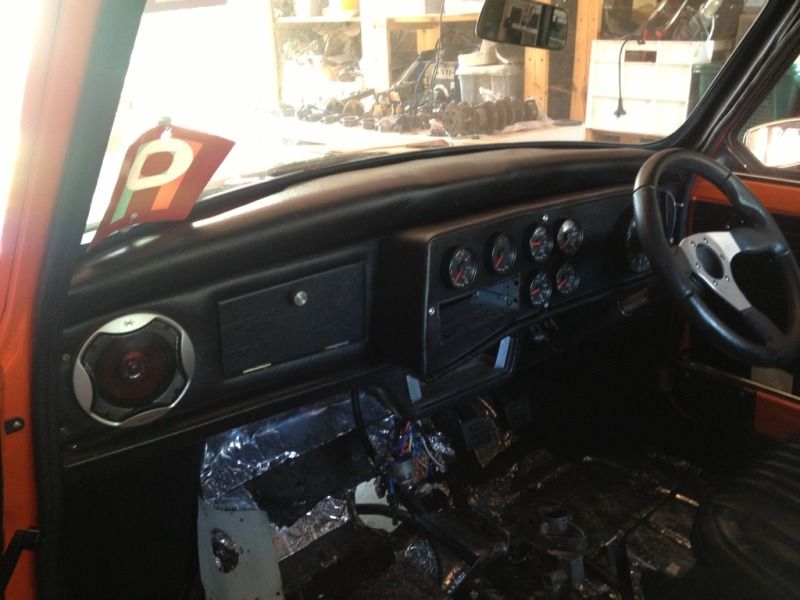

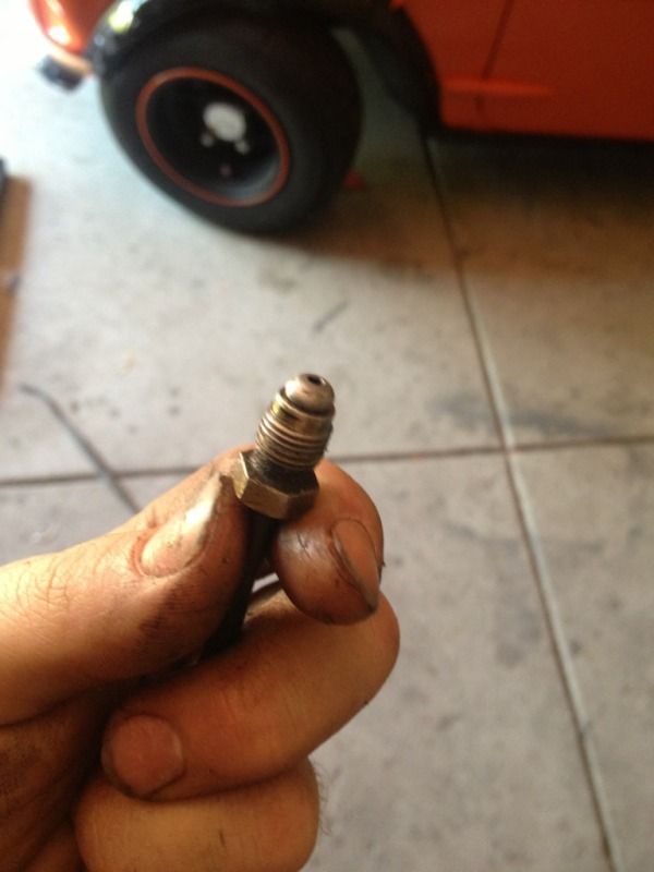

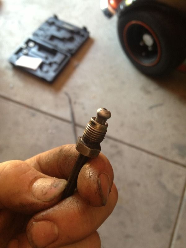

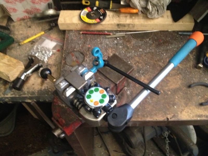

This morning brought this from the post man! Had spent less on a cheap pipe flaring tool and it produced flares like dropped pies.. This however, is awesome! Well worth the money!
This is the first attempt with it..
Worth every cent!

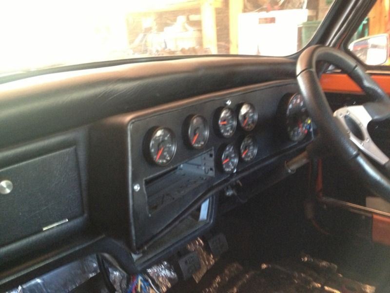

I also got bored as usual so covered the new dash panel in vinyl and then painted the facia quickly with a rattle can to see how it looked, good in my opinion..

PostPosted: Fri Jan 11, 2013 1:07 pm
Posts: 10654
That looks pretty good all painted.
Is it going to stay black or will you do the dash in orange carbon or something a little different?
PostPosted: Fri Jan 11, 2013 3:40 pm
Posts: 4682
It's trimmed in vinyl but the face plate will be black with an orange pinstripe and my logo in it, nothing too over stated. Will get rid of those shite speakers too and get something decent either a two or three way setup

PostPosted: Fri Jan 11, 2013 4:15 pm
Posts: 18888
I'm pretty jealous of your flare tool, the traditional style makes for quite a bit of work. Well done.
PostPosted: Fri Jan 11, 2013 4:39 pm
Yeah, share the details!
If I can't find my old one I'd like to get one that can do that nice a job.
PostPosted: Fri Jan 11, 2013 4:51 pm
Posts: 4682
This is it here, there's a $400 kit which has more dies but you only really need the simple version for a mini, importantly does the bubble flare, which, opposing what I've read on here is the correct type needed for minis. Double flairs are used on a couple of joines ie: rear subframe, but it does those too, you just turn the little dial to the desired type of flare. Pull the handle, job done

PostPosted: Fri Jan 11, 2013 10:53 pm
So, it does a double flare in one motion??
If so, thats the duckz gutz right there!!
Excellent Sean!!
Tricky
PostPosted: Sat Jan 12, 2013 8:23 am
Posts: 4682
Double flare is a two motion thing, but all you do is pull the lever, let it off turn the dial to the double part, then pull it again.. It's so easy
