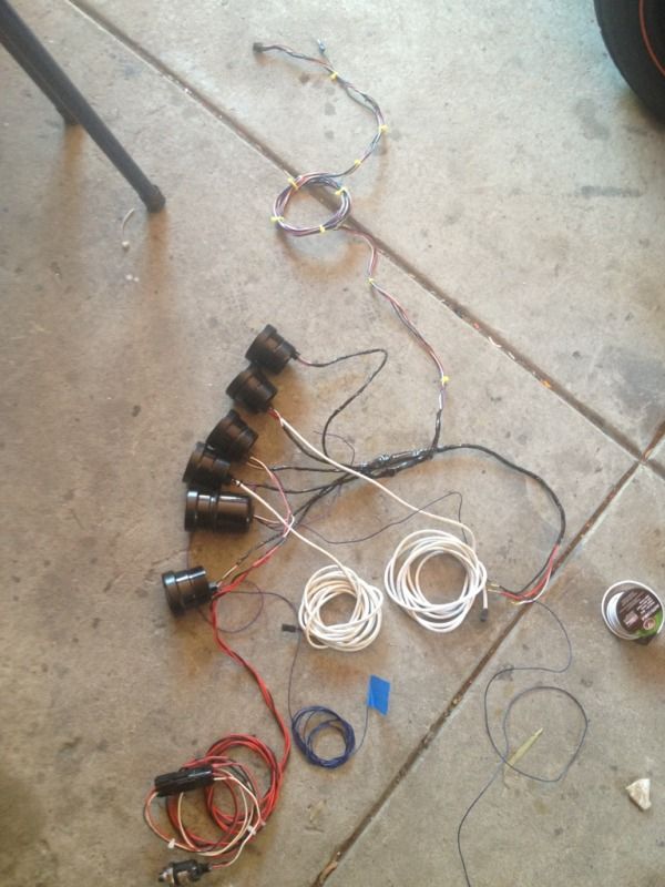

Decided to make my gauge loom today.. Which was full of fun when there's 7 of them including the tach. But got there in the end, (should) all plug in and go now when I get everything back in the car!

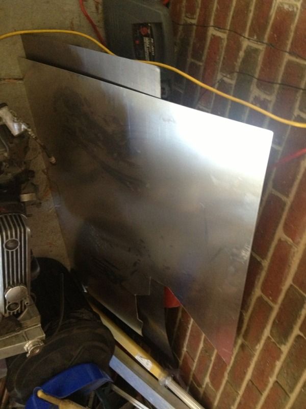

And today being most people's return to work my mates at the fabrication shop down the road were back open so I could buy some sheet metal to build some panels patch some holes and do some interesting things with the bonnet (but I won't show that until I'm confident it looks good)

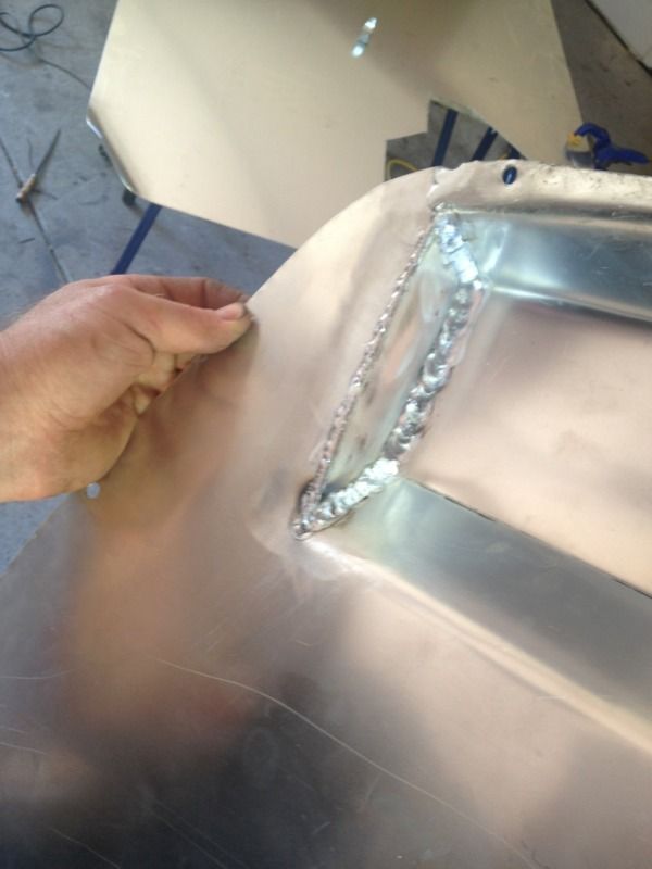

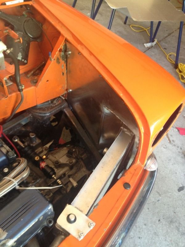

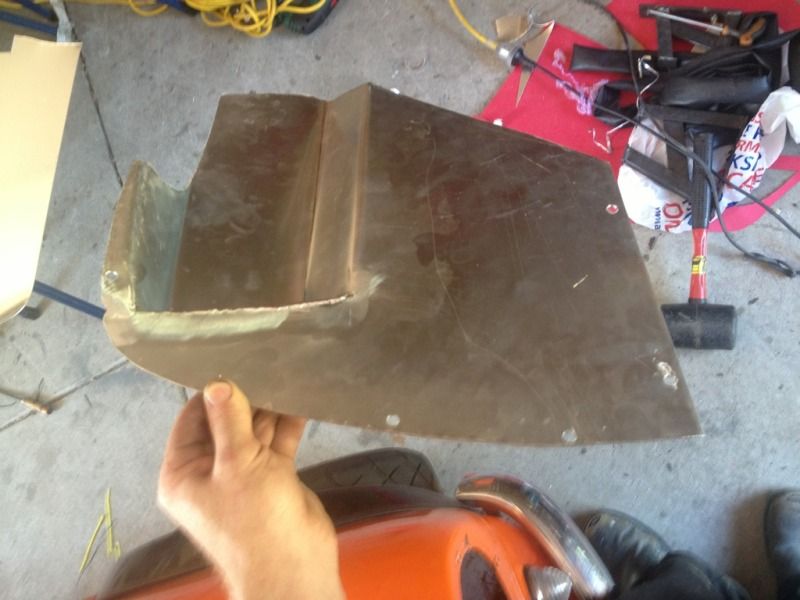

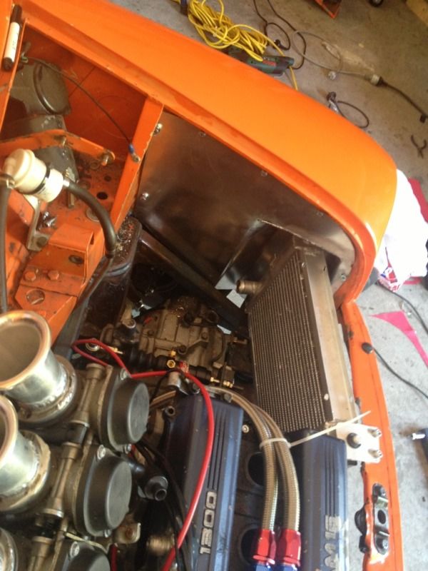

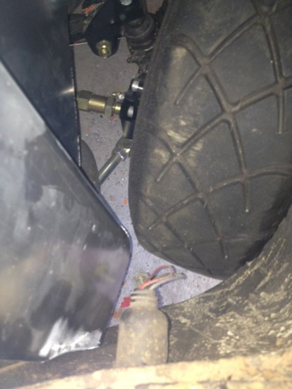

So I started by making the passenger side inner gaurd panel. Fits fairly snugly, clears the radiator, headlight bowl and wheel at full lock.

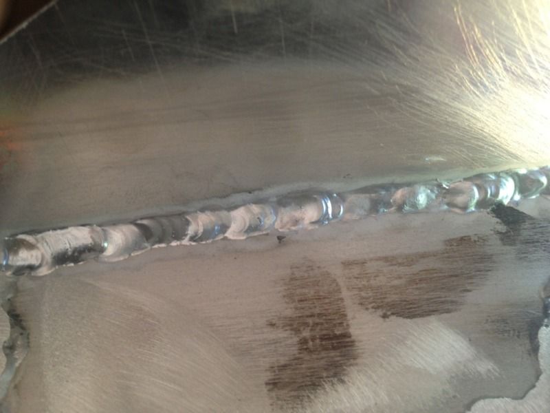

Welding thin ally sucks..
Enjoy my shitey fab skills

Have you checked if it will clear at full suspension compression?

Yeah, heaps of room, it's actually a bigger gap then it looks

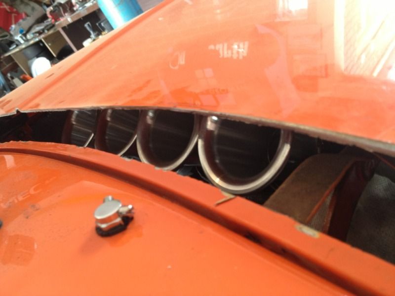

This be the reasoning for modifying the bonnet..
Going for something similar to what carbon weezel sell as a 16v bonnet, but a little different as front of bonnet height isn't as critical. It's freakin hard to fabriate I can assure you.. Spent al day on in and still am having trouble getting the front to contour corectly

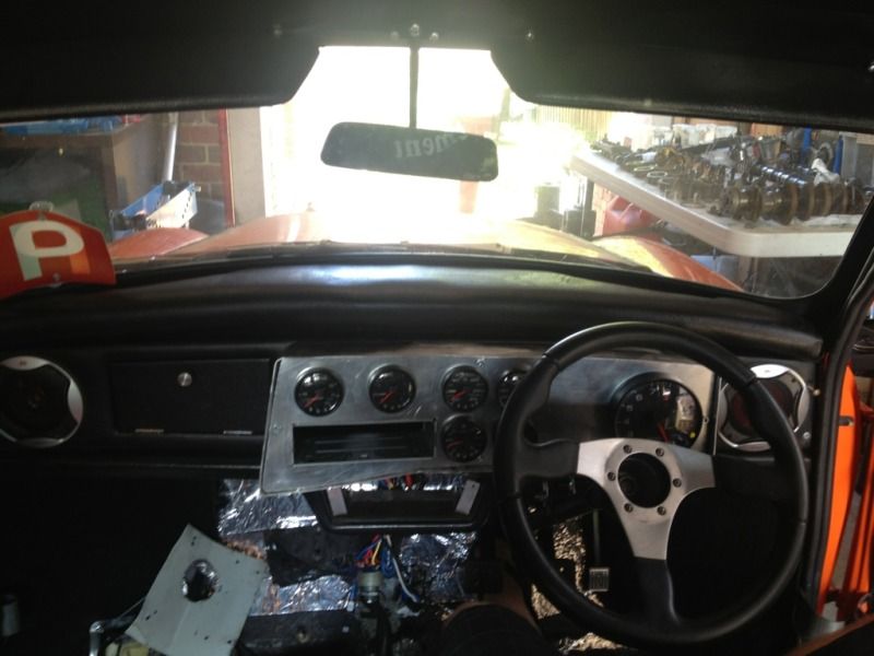

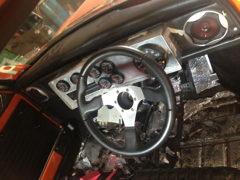

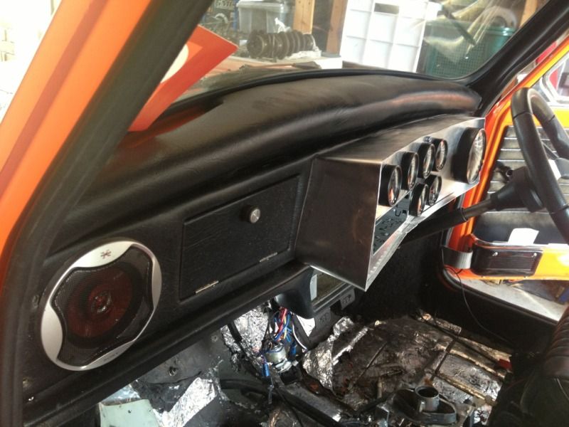

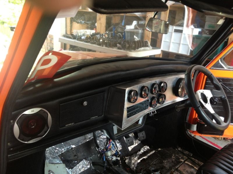

Started making my dash pod today, got it 90% there just need to trim the outside in vinyl and paint the face plate. There will be a speedo in there too when I get one.. Looks a bit big and bold now, but trimmed in black it won't be too bad I think, and it serves a purpose, clearing a space where the pedal box is.
