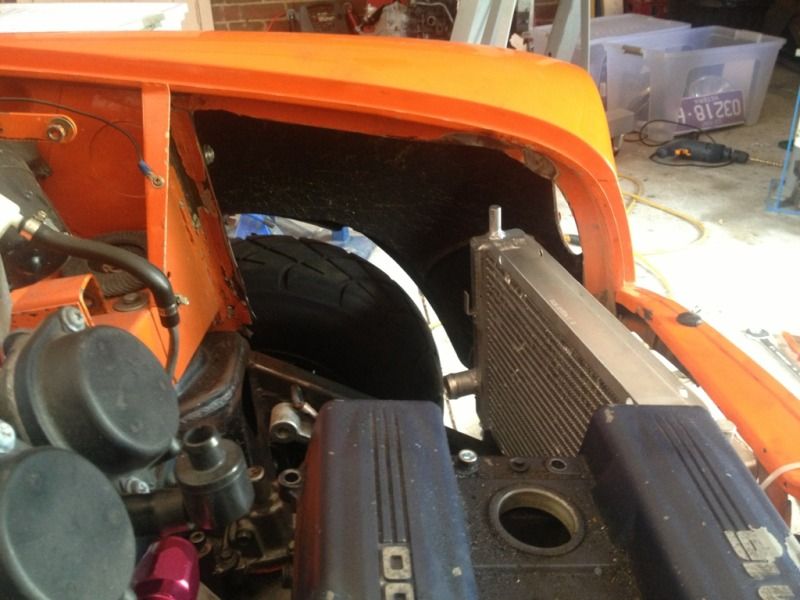

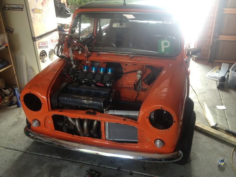

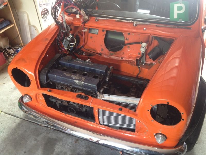

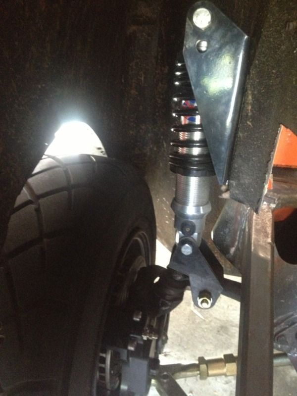

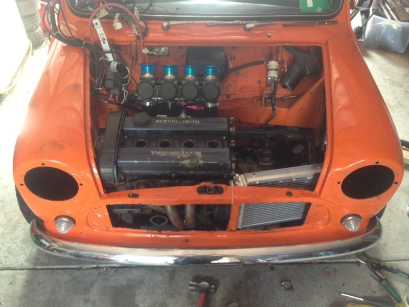

Made some progress today, cut away the passenger side inner gaurd, to make room for the radiator. i will make an aluminium panel to fit in its place. the other side only needed half the panel cut away to make room for the alternator. i also put the gearbox, block and head together and trial fitted it just to see if everything was where is should be, which it is!
Also fitted the coilovers

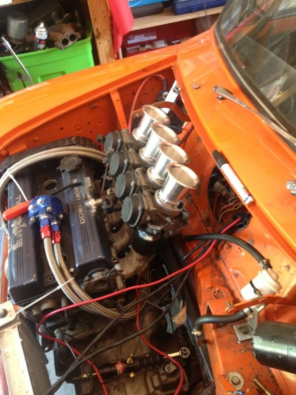

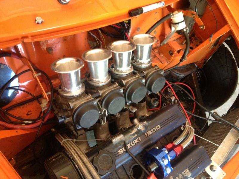

Did a bit more today

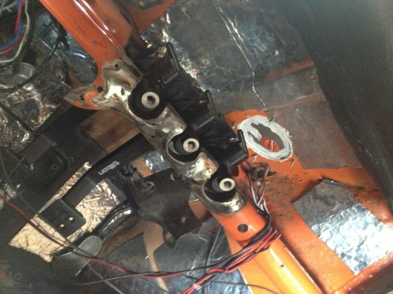

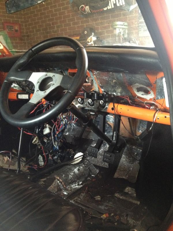

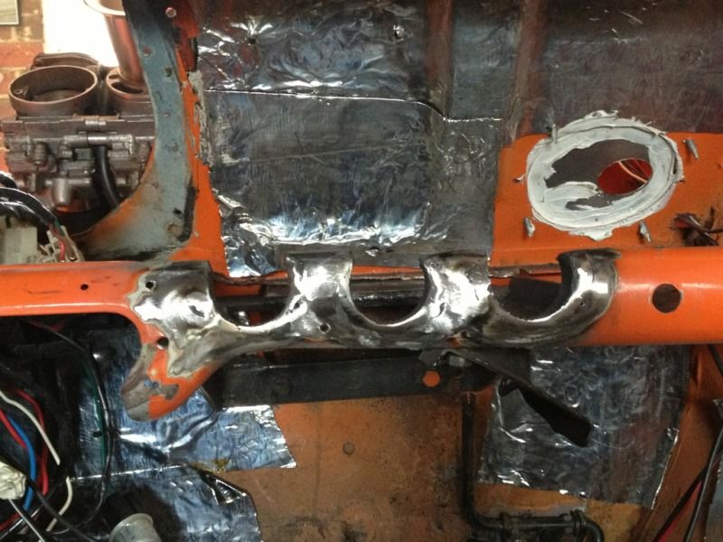

Cut the metal away to allow for the brake setup, also cut the dash rail and added some metal in to finish it nicely, not 100% neat but a bit of bog and ittle be fine for something you will never see..
Perfect position for the feet which is good!

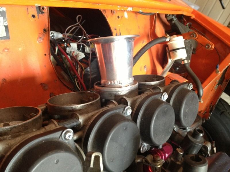

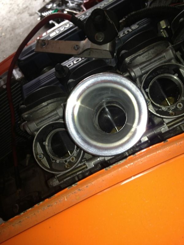

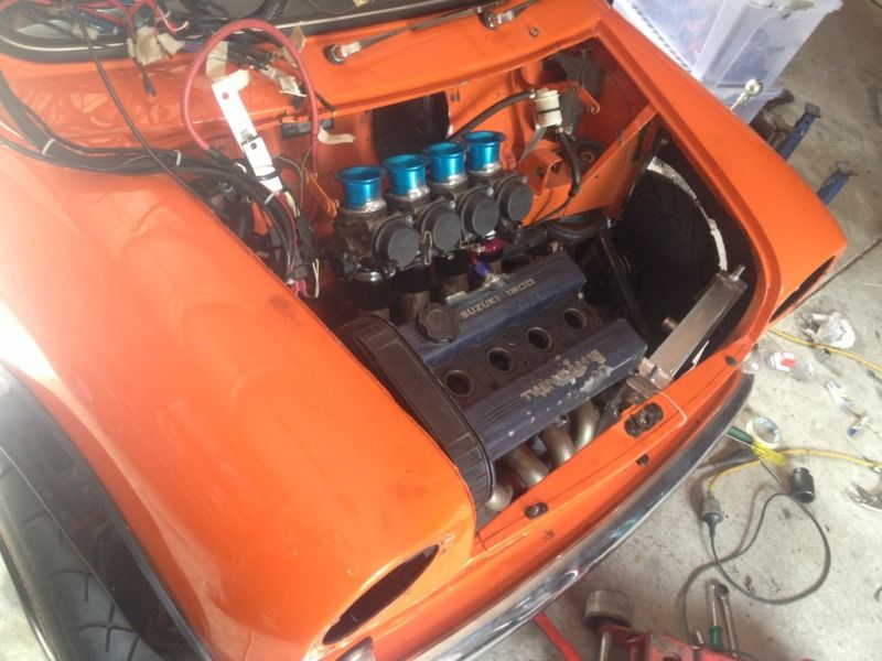

Also made one of the new ram tubes, it's welded to the original inlet for the carb, the old ones left a lip on the inside which would of been in efficient, these are flow tested ones and are 40mm at the base so there Is no lip on the inside just smooth passage for the air
More as time permits

why would anyone put a bump in an inlet?? strange design.

The old cheapo ram tubes were too big on the inside so they had a step where it met the carb.. These are far better, and of course far more expensive ones

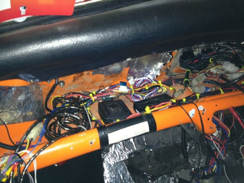

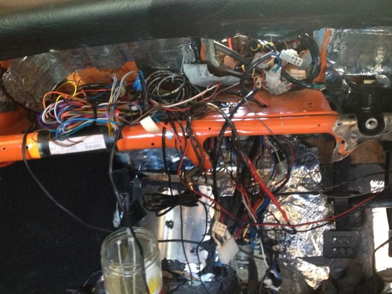

Nothing has been open for me to buy materials and welding gas so all I've done is tidy up wiring!
Here's the spaghetti junction I started with after installing so much alarm, central locking and stereo gear.. Looked a bit messy:P
And so far.. Still got some to go
Note the 2005 hay scrutineering sticker taped on the dash still.. Obviously didn't take it off when I put the dash in!
Anyway.. Exciting I know

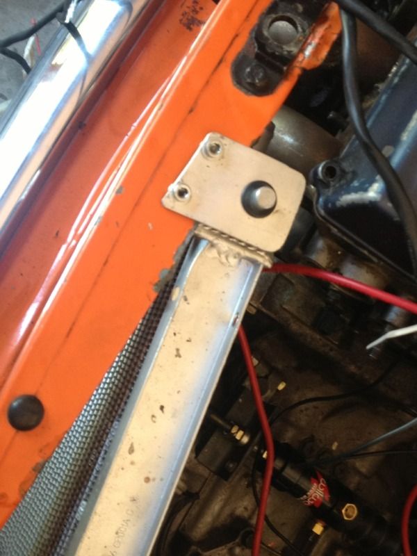

Finally got some welding gas today so finished my ram tubes off, also got my nutcert tool so I mounted the radiator top bracket.. But have a massive head ache so Cbf doing anything else!
