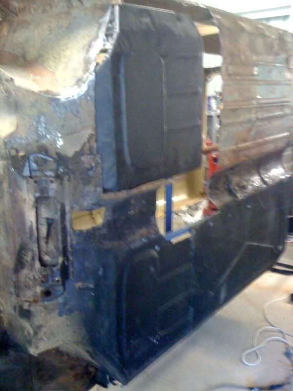

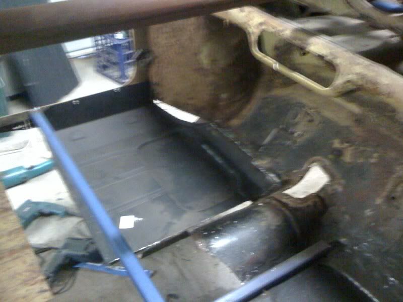

Well I finally got some time on the weekend to start fitting the passenger front floor pan. The firewall panel was rusted out beneath te floor so I had to cut that out as well and fabricate a new bottom - will take some photos and post for you. The bottom of the inner guard was gone, the inner sill was gone, obviously the outer sill is gone but I have new ones ready to go in.
I am not going to weld anything to the tunnel or front to rear floor pans together until I make up a frame to sit under the floor to make sure everything is flat and straight.

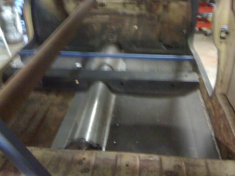

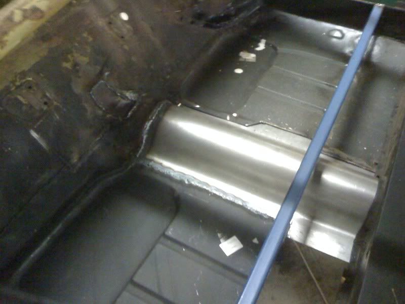

I have found a few spare days to work on the mini recently :D and have achieved a little bit. I finished off the new passenger floor, inner guard and the double panel on the fire wall. I have filled the old shifter hole in the centre of the fire wall and have installed a new centre tunnel as the old one as nasty...
I hope to have the floors and sills finished off within the next couple of months. I will have to install a new rack and the subframe and fabricate the mounts for the new engine...
