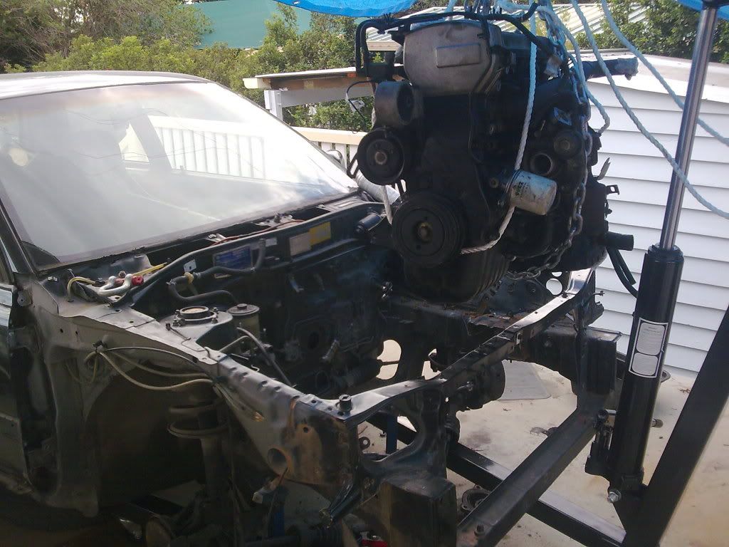

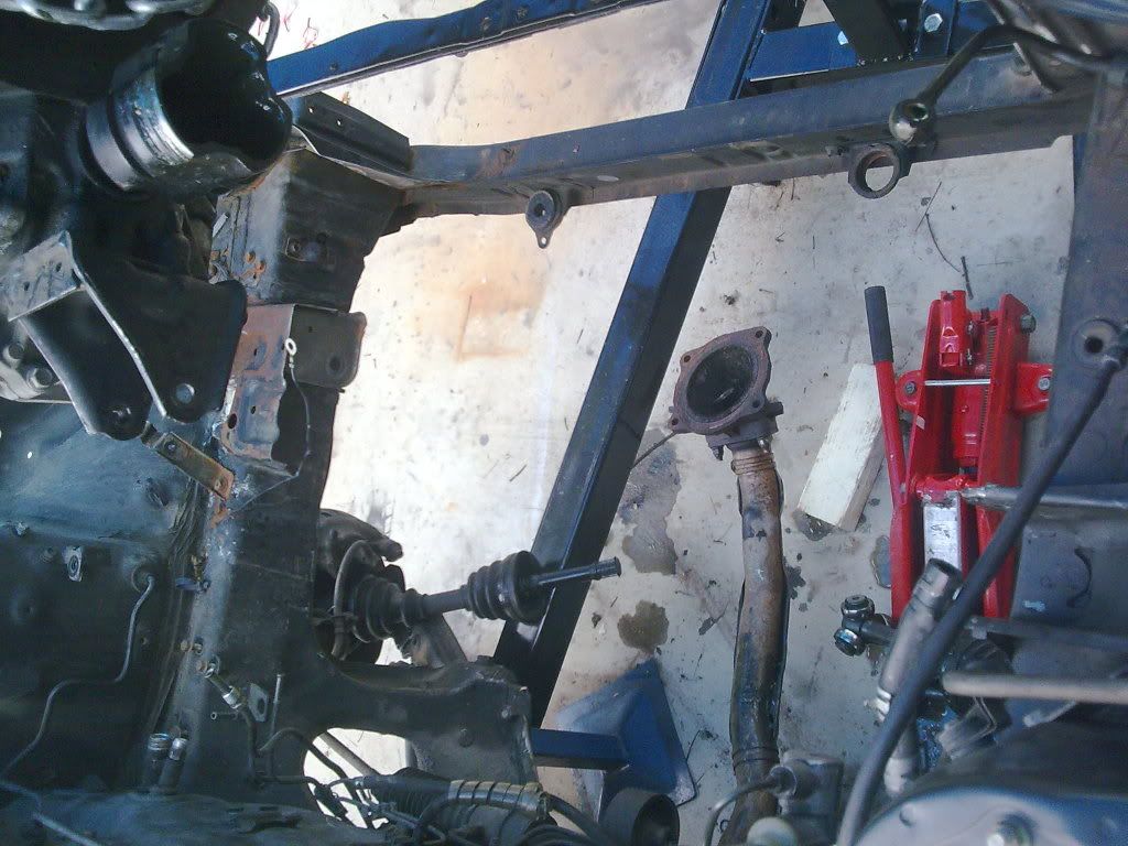

Ive made another step in the project. Finally removed the engine from the donor car. Sometimes it made me regret getting a whole car, everything is so much bigger and theres a lot more to faff about with. But its out now so thats all that matters.
Pics are below.
The engine while leaving its former home
The ridiculously big engine bay compared to where its going
Next step is to bolt my gearbox on and flog off the auto then organise packaging and whats going where in the engine bay.

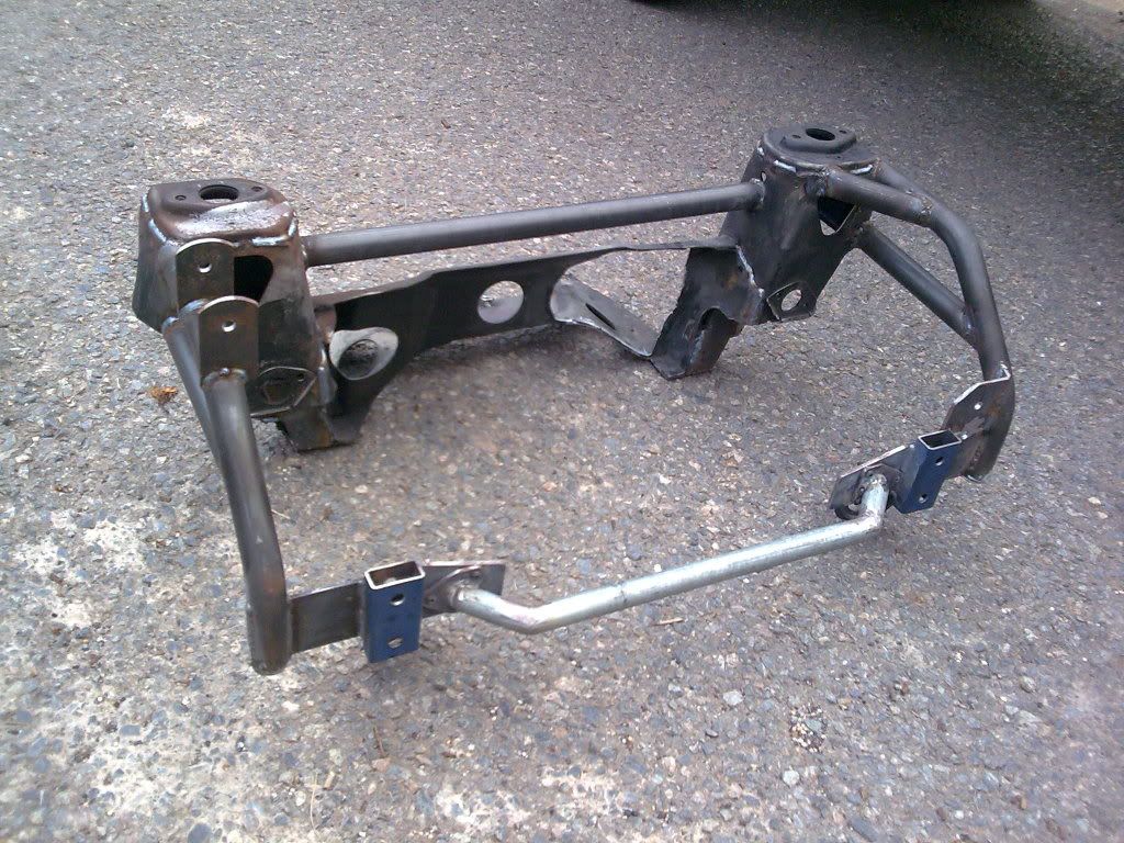

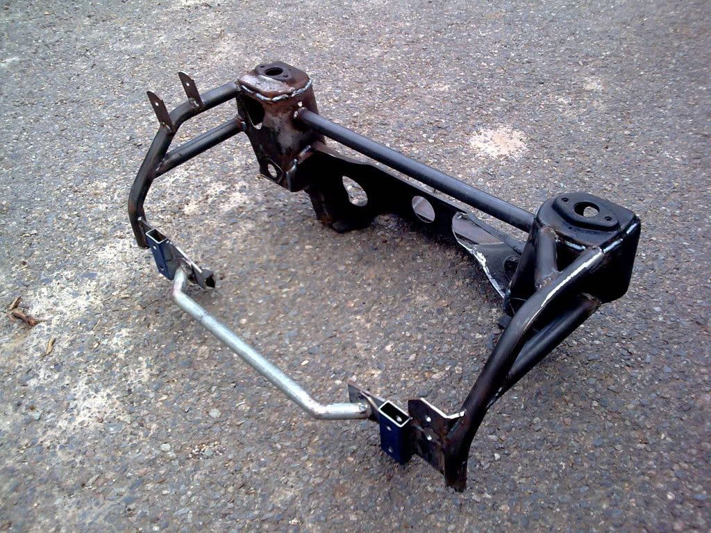

I havent done to much lately, but ive got a big update now.
I decided a while ago i really dont have the equipment or the skills to make my own subframe, so i ordered one off Tricky.
I have it now and its looking brilliant, id reccommend it to anyone who is doing a conversion, its a fantastic bit of kit and very very worth the money.
To say im happy with it is an understatement.
Once again Tricky, thanks for your help.
And heres a few piccies of it.

PostPosted: Sun Feb 21, 2010 9:29 pm
Posts: 3981
Excellent. Get some paint on those welds quick smart.
PostPosted: Mon Feb 22, 2010 12:58 pm
Joined: Tue Nov 25, 2008 11:47 am
Posts: 68
Location: Perth, WA
Definately the best subframe ive seen...
Top work tricky!
How does the gearbox mount fit?? Any pics?
PostPosted: Tue Feb 23, 2010 10:30 am
Posts: 953
Location: NOR, Perth, W.A.
Have a look at the vertical flat plate with 2 holes on the RHS of the subframe. There will be a bracket that holds the gearbox (from the standard gearbox mount location) to the subframe.
It's quite good really because it means that once that bracket between the subframe and gearbox is removed, the whole engine can be removed from the top with minimal obstruction. :D :D

PostPosted: Tue Feb 23, 2010 12:40 pm
Posts: 2002
It also comes with 2 brackets that join the engine mounts on the engine to the mounts on the subframe. Ill get a pic of the engine in the frame once ive fixed my daily mini.

PostPosted: Tue Feb 23, 2010 12:45 pm
Posts: 953
One for the gearbox and one for the rear lower mount? I look forward to seeing how it fits and how much of the inner panels have to be removed also.
