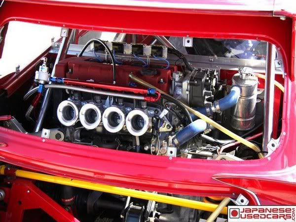

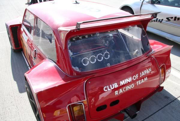

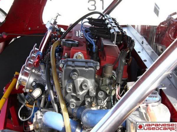

That car runs in Japan, some crazy class whereby you can run anything you want.
BTW - that Mini is rear-engined, so ineligible!!
But still certainly a beast none-the-less.
Tricky
PostPosted: Mon Jun 29, 2009 12:11 pm
Go on,,, build one like that Tricky,,, you know you want too :-)
Who cares what class you run,,, it has the potential to beat almost anything else on the track anyways,,, AASA rules will let you run it,,, hillclimbs entered as a formula Libre will let you run,,, almost all the street sprints will let you in,,, almost every form of racing is avaliable to you with such a car
:-) i know you want too :-)
