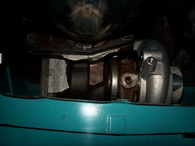

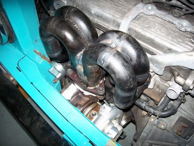

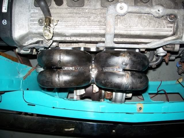

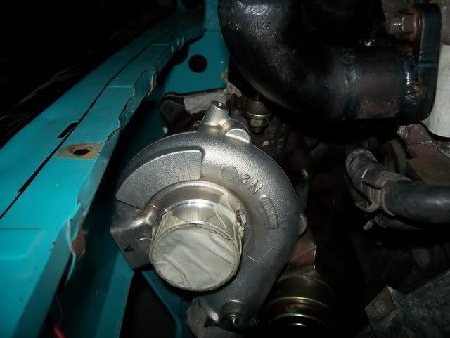

Hi All,
Just an update on Barbie, and where we are with her.
Dropped into the fabricators today, and they had finished the exhaust manifold, and had started woking on the dump pipe. I must say, that the manifold does look good, and will look great once the HPC coating goes on.
We will take Barbie back home this Saturday, to have the guards altered to suit the bigger (wider) wheels, and test fit a few other things, like the flares, inlet pipes, airbox and so on. Then its all back together, and off to the auto electricians - so we shouldn't be too far away from a finished product - perhaps 6 weeks!
Anyway, here are some pics of the finished manifold, so enjoy!
More updates later.........
Tricky
