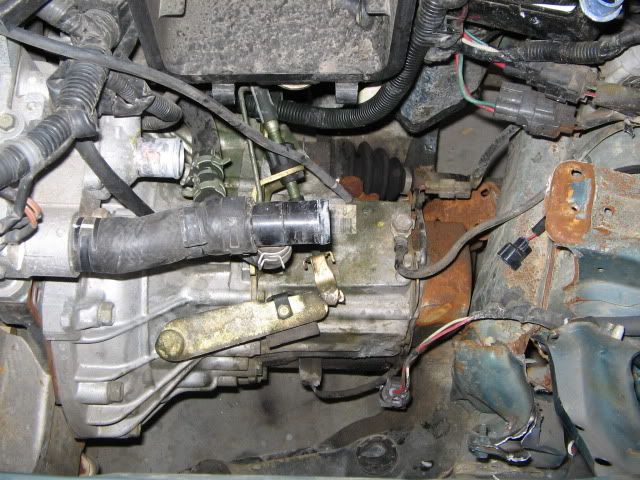

Picked up the sirion yesterday morning and had to take it to work to pull the front LH rail foward as it was badly bent and couldn't fet to anything. Found that the gearbox mount had broken off and damaged the gearbox case. I'll have to get this welded before final fitment into mini.
Also pulled the motor out also the dash and steering column. They are a pretty small motor/gearbox combo.

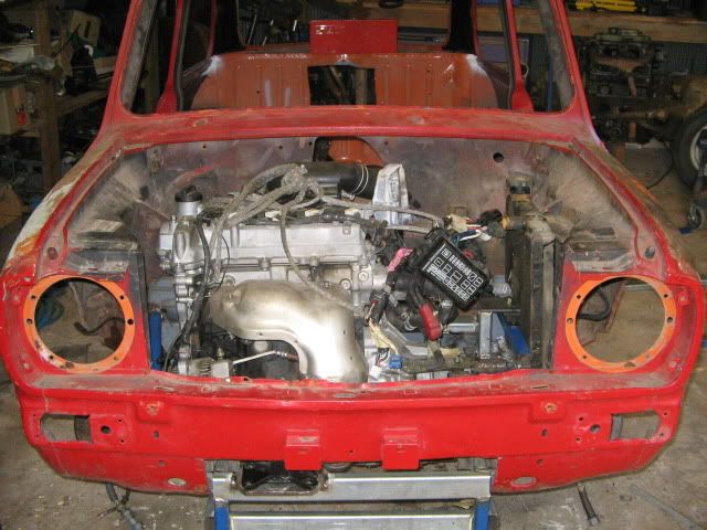

Well guys I've now been doing the engine conversion since christmas and is getting pretty close to final fitment except for removing for the respray. The main problem has been that the complete firewall had to be cut out and I have fabricated a new one from scratch that also holds the sirion booster and master cylinder.

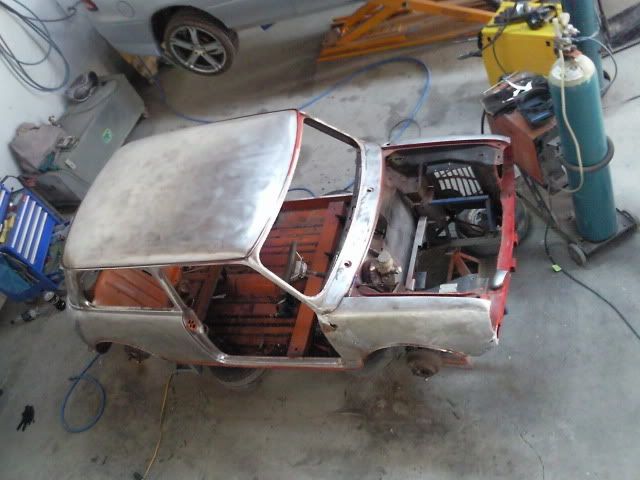

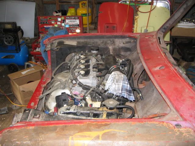

Just started working on it again after months patiently waiting for me. Been trying to upload photos and think I've finally worked it out so here goes.
and this one
