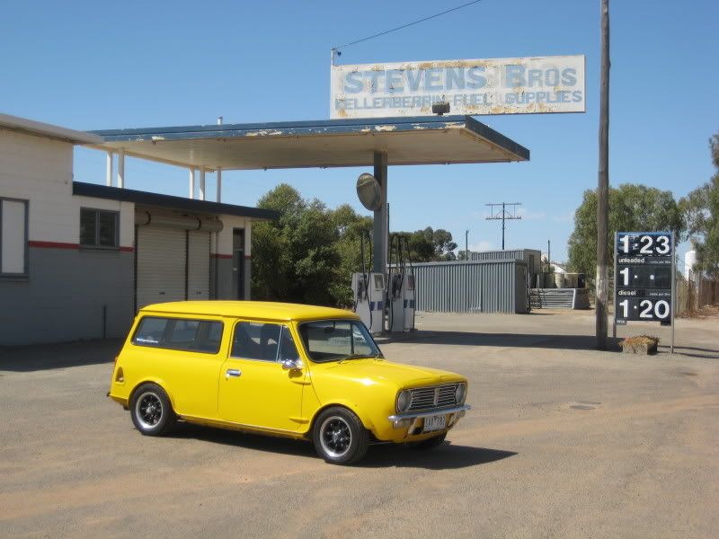

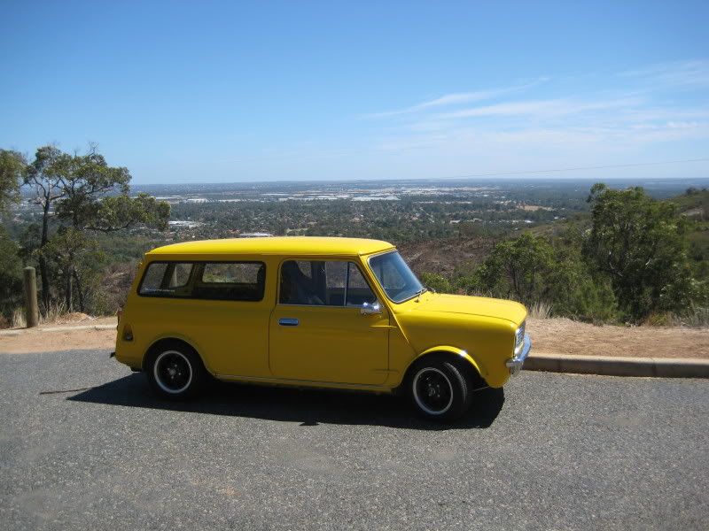

Here's a couple of pics taken on the grand adventure when I wasn't so stressed out about something breaking/coming loose on the car.
Pit stop at a nice park in Tammin (about 3/4 of the way to Perth):
A dead end street I found in Lesmurdie (near the engineer's house) in the Perth Hills:
And an aptly named servo in Kellerberrin on the way home:
(Stevens is my last name and I have a brother, hence apt! :roll: )
-James.
