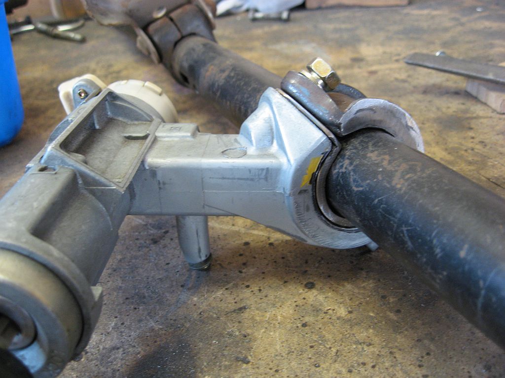

I wanted to retrofit as much of the Starlet gear as I can in the Mini to make the wiring easier - this includes the combination switch assembly for the wipers, lights, indicators etc as well as the ignition barrel which therefore need to be mounted onto the Mini steering column. The Mini steering column is smaller in diameter than the Starlet so like everything else, a custom bracket was used.
On the EP82, the bracket which mounts the main switch assembly in the Starlet is actually welded to the steering column so this had to be cut off.
Even though the Mini does have a steering lock mechanism, the Starlet ignition barrel will be mounted higher up the column than the Mini one so the Starlet locking pin won't be used and was ground off.
To allow the ignition barrel to bolt around the smaller Mini steering column, I simply welded in some half tube on one bracket (on the right bracket in pic below) and then made another piece to sandwich between them (middle piece in pic below).
For the plastic cover to fit around the switch assembly and ignition barrel, the switch assembly and ignition barrel had to be a specific distance and angles to each other so a section of tube was welded between the two factory pieces.

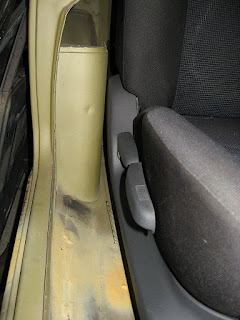

My design was overengineered but I am comfortable with this since I don't stuff about with essential saftey items. The seats were positioned inward (away from the door) to achieve two things 1) Better lining the driver up with the slightly offset steering wheel 2) Stop the seats from hitting the rear map pockets when it's moved back on the sliding mechanism.
The height of the seats was positioned to allow the sliding mechanism to move over the top of the cross member if for some reason a short person (not me) drove the car and had to move the seat forward.

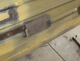

Unfortunately while making these frames I forgot that VSB 5B requires that the centre line of the bolts need to be aligned with the top or bottom of any corrugation and be complemented with a shaped backing plate underneath. I ended up with this :(
... so I decided to modify the floorpan to remove the sections of corrugations that were in the way.
Note the evidence of part of the messy welding job (not me) next to the new plate that was done to the shell when I got the rust removal work done. If only I had the Lincoln MIG before getting this work done :roll:
Once those pieces were welded in and holes drilled through them for the bolts, the seat mount frames were bolted in place with a 120mm x 50mm x 3mm reinforcing plate with 8mm nuts also welded in place - for adherence to the necessary standards.
