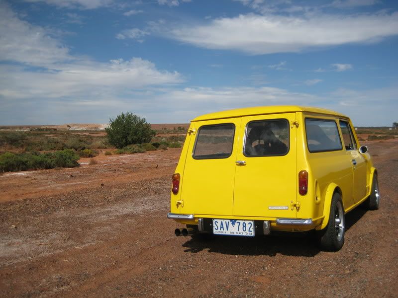

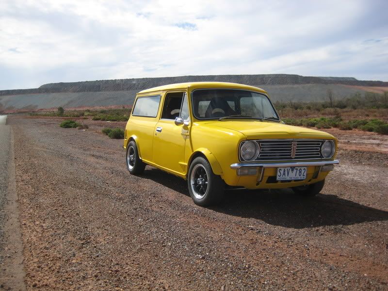

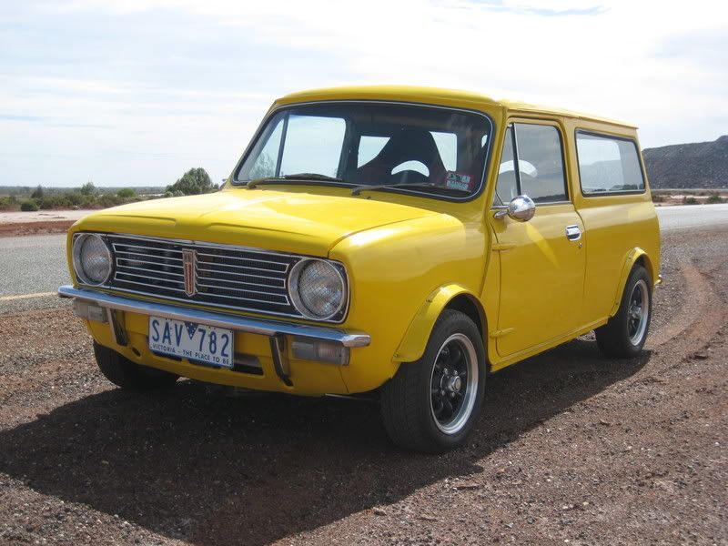

Went for a bit of a spin to check out the cooling system capacity (its 40+ deg C today) and decided to take the digi camera with me.
On a nice quite road:
(I like this pic /\)
