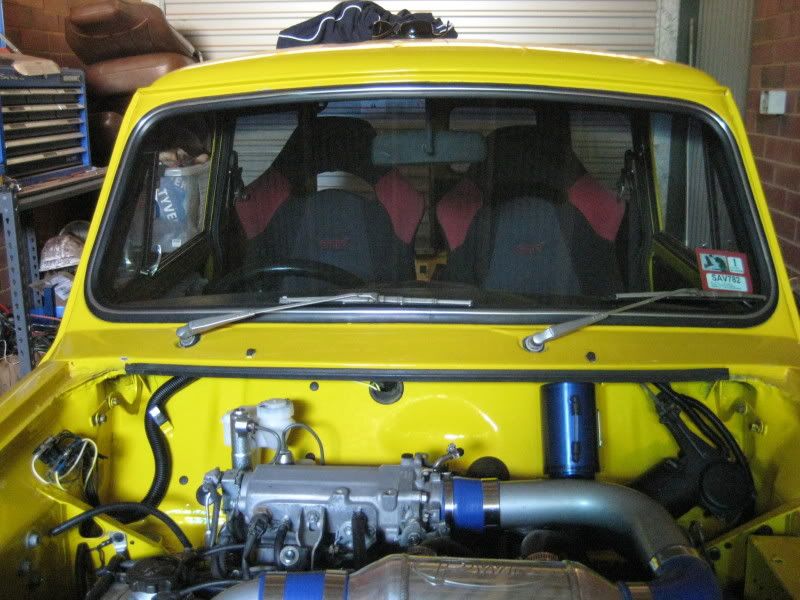

I am also not completely happy with the washer bottle under the dash, but I didn't want it in the engine bay. Thanks for the tip about the RS wags bottle. I will have to look into it a bit further. (Not many RS's here in Kalgoorlie though so I may have to buy one and try it out.- My bro lives in Tassie! :roll: )

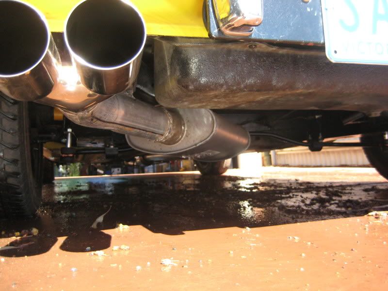

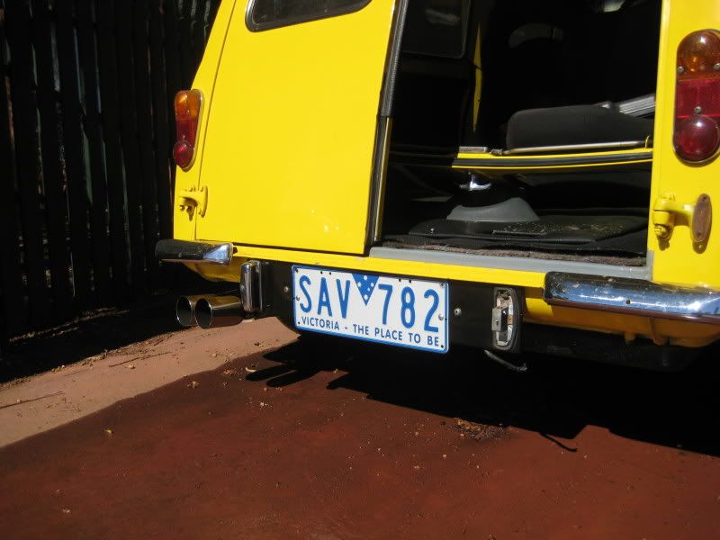

Exhaust is 2.5" with blitz cast dump pipe, magnaflow high flow cat, & Lukey muffler, with twin 2.5" stainless tips. its pretty burbley at idle and has a great rasp to it higher in the revs. :twisted: looks good too, if I do say so myself!
The drive shafts I got made by Rotomotion in Perth. These ended up taking a fair while to get back, due to waiting for the heat treaters. They are turned from new billets and ended up costing me just on $900 including postage to Kalgoorlie.

As for the dash, I've sorted a few electrical gremlins I had and fitted relays to the lighting system. cut off switches were also added.

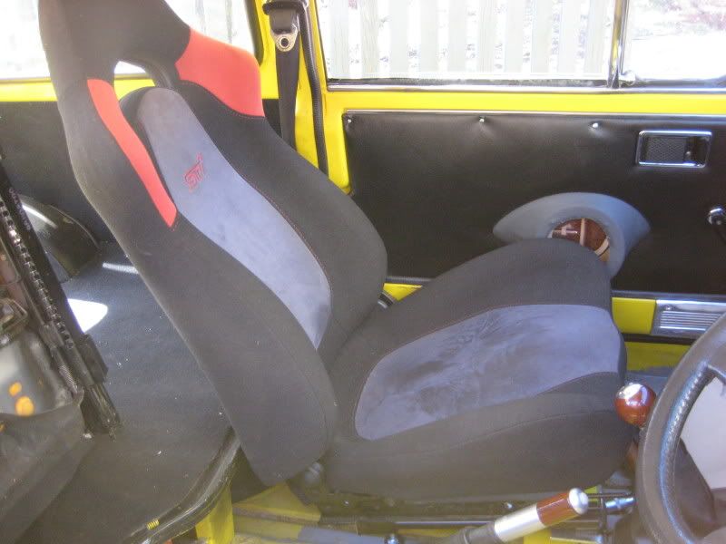

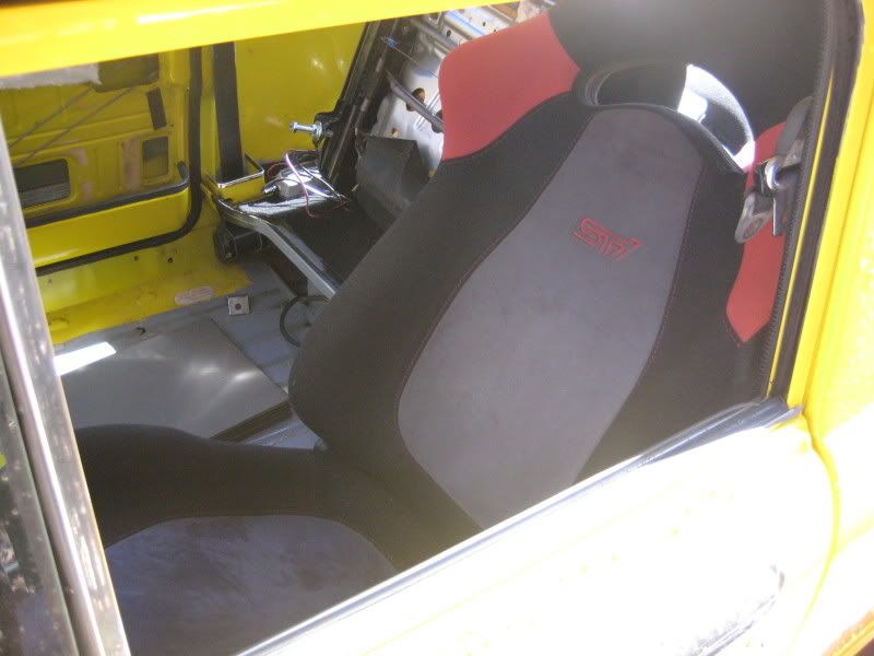

I also have just about got my seating sorted out with a set of wrx sti seats. They fit okay and are the most comfortable seats my arse has ever felt. The driver's side mounts were being painted when this pic was taken.

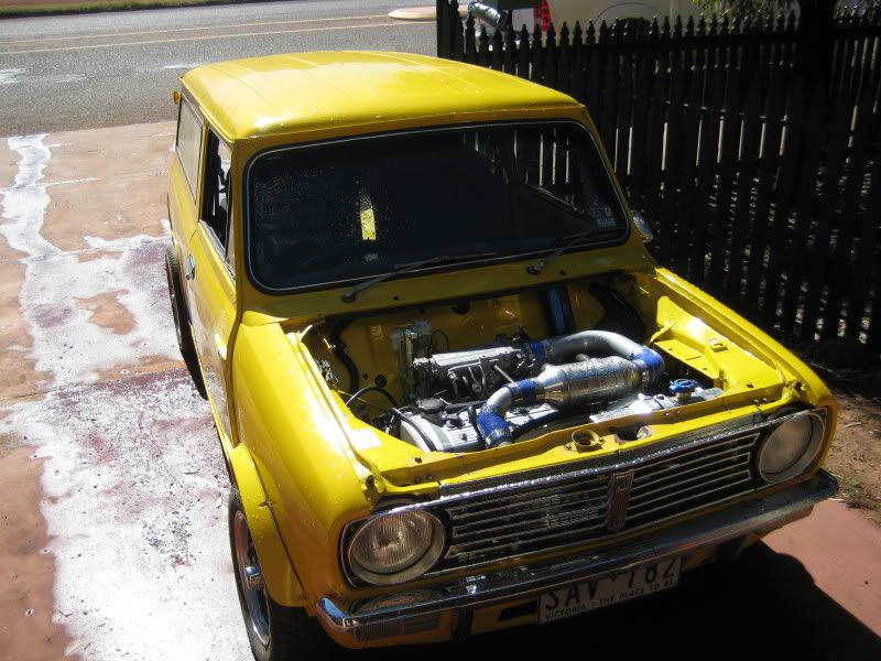

I have also added a small reservior to the intercooler cooling system that seems to be keeping the temps under control at this stage.

Caponix: The seats are not bad width wise. I have a centre console which makes it a little tight for the passenger seat, but the shoulders of the seats dont touch the sides of the car or each other and I get basically full range of movement for the drivers seat - which is very good for a van! The seats are out at the moment as Im making a mess with the bodywork, but rest assured pics will be posted when they're back in. :wink:

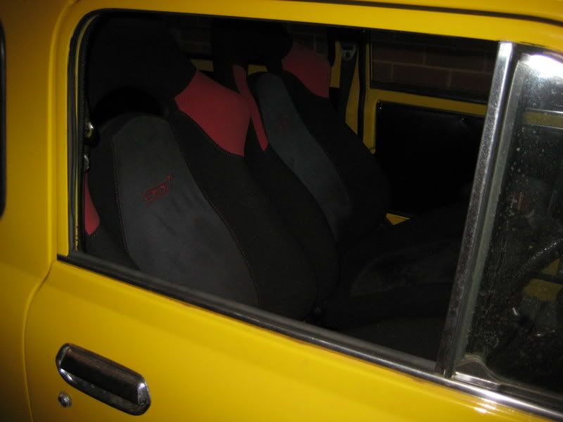

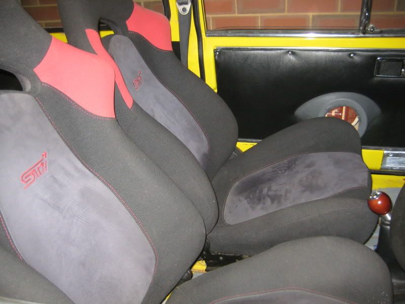

Here you go Caponix, a few pics of the seats:

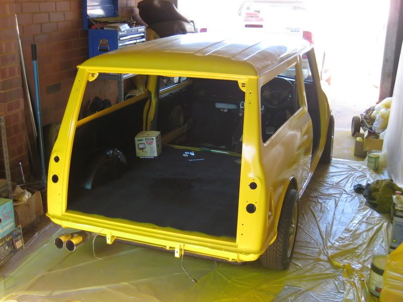

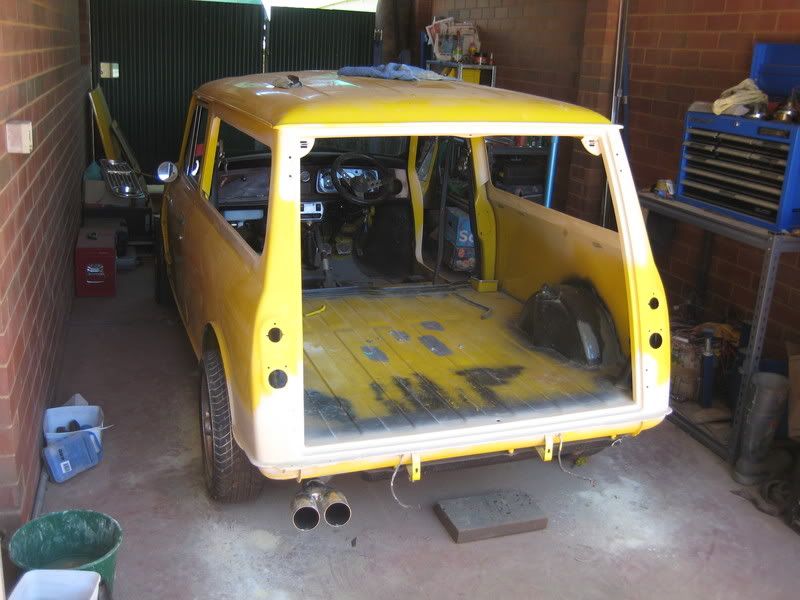

:( Most of the repairs concentrated around the back of the car, where there was a bit of rust starting to bubble through. I also had to replace a section of the rear 1/4 just infront of the driver's rear wheel due to rust.
(Plus fix the dent in the door I mentioned in the last update. :oops: )
The main Issue I came across was the depth of the paint. One side of the van had 3 layers of primer and yellow which ment once I had wire wheeled down to bare metal on the dodgy areas, I was left with a pretty sizeable dent! :x
But as always, bog to the rescue!
This weekend I hired a compressor and sprayed the top coats, and apart from a couple of dust spots which I think should come out ok, I reckon it looks alright.
I ended up painting both rear quarters, the rear door surround, driver's door, hinges and A panel, and the radiator support panel. I also gave it a bit of a spray over inside the load area, although this wasn't a concern as it will be covered in carpet.
