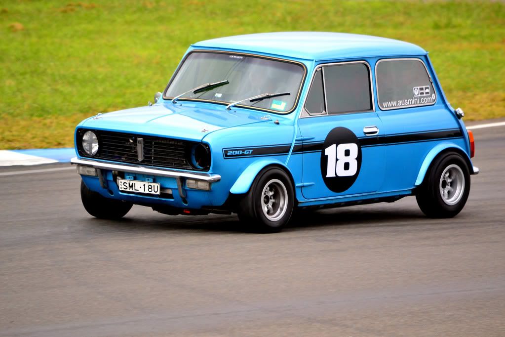

PostPosted: Fri Jul 29, 2011 10:53 am
Yea the RSW's are my favorite rims but i couldn't justify the cost of a new set ($4k) and i needed a specific offset to get the look i wanted in the 10's.
The car sits much nicer on the road and is lower and wider and tougher, but most importantly drives a hell of a lot better.
Here are some pictures:

PostPosted: Fri Jul 29, 2011 10:58 am
Ooo,,, looks like it Squats pretty heavy in the front
& have you looked at sorting the Bump-steer at all?
nice job tho, love the stripe/decal thingy, suits it nice
PostPosted: Fri Jul 29, 2011 11:14 am
floss wrote:
Fair enough then. Is that a road or track beast he has? Sounds awesome.
It's street registered in SA - but would not pass in NSW,
There isn't a hell of a lot of weight transfer to the front, most of it is left to right - i'm planning to put a sway bar front and rear to keep the body roll in check.
When i switched to the 10's the bump steer was almost eliminated and is not a problem for me now.
