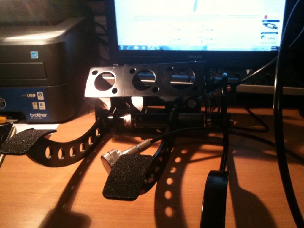

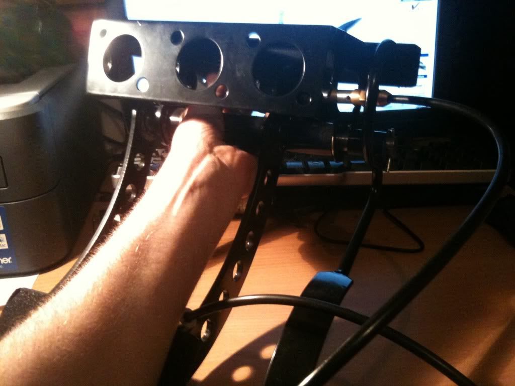

Ive just got it out of its box and got a few quick photos. The adjuster knob is easy, theres a grub screw to hold the cable in, so take that out and it comes off.
Means i can put it in if i need to adjust the brake bias easily.
And if you need to change the bias enough you change the master cylinder size, its far easier to change than a mini system.
