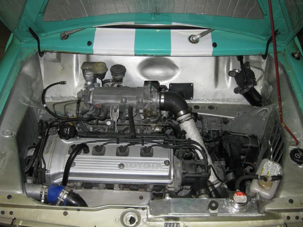

hey there,
Clutch master installation was a piece of piss.. I just modified the pedal leverage lengths to make sure I get full stroke on the master cylinder. I would trust that unit over the standard mini one any day! Anything toyota is good :P which why I used the wiper motor off the starlet too

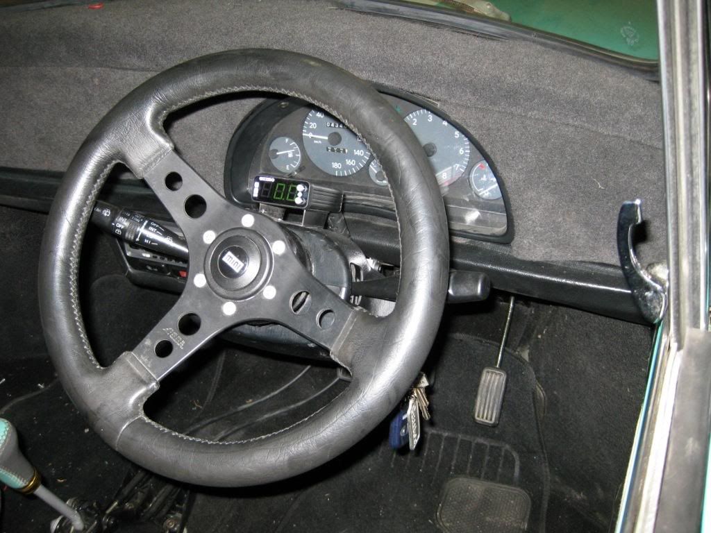

I used the starlet dash as well. Makes wiring up very simple.
pic of the engine bay.. wiper motor is middle right.. obviously :D
best of all.. you can do this with the starlet dash!! available from ebay
I can post a pic of the clutch master if you like

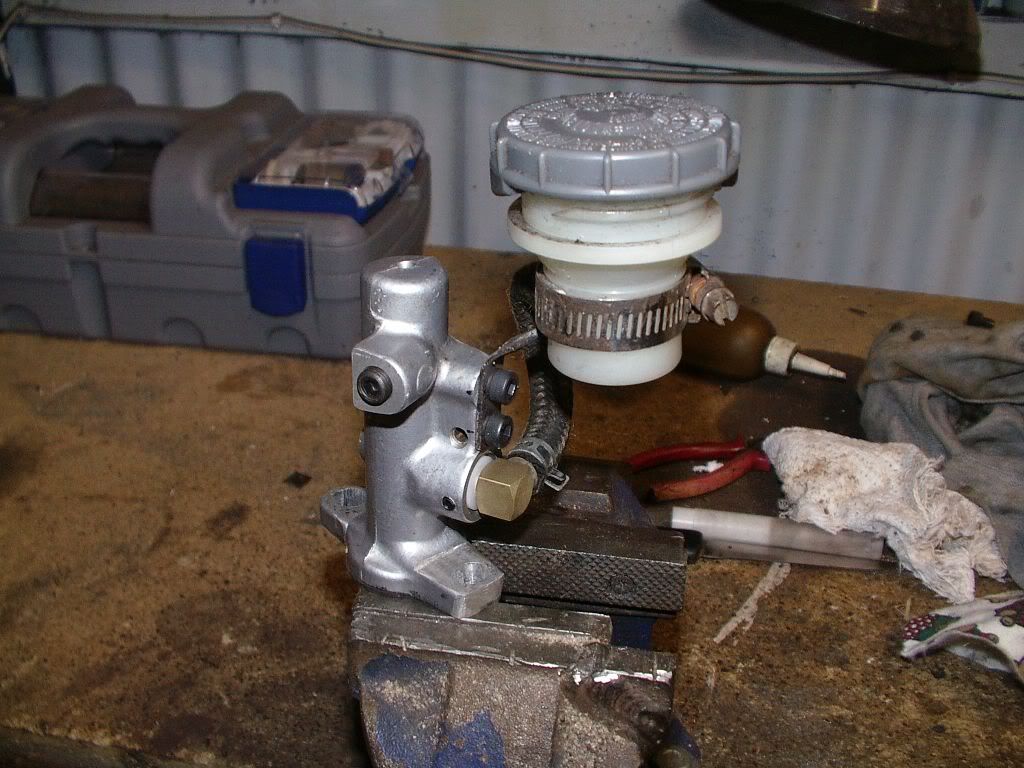

If you have the picture that would be great..

the actual reservoir was from a Honda civic. You won't be able to use the starlet one since the fill cap will on the wrong orientation.
Just go to a wreckers and get yourself any remote type reservoir
I got a small teflon bushing turned up to press fit into the hole into which I tapped a thread and just connected a brass fitting with a barbed fitting to take the rubber hose.
I made a small bracket up for the reservoir and fitted it to the master cylinder body.
It is working to date with no issues

Nice, was it difficult fitting the dash in? did you have to trim the sides to get it in or does it fit in snug..
Thanks for the photos.
Ash.
PostPosted: Tue Aug 04, 2009 11:02 am
Joined: Wed May 30, 2007 4:30 pm
Posts: 158
its not an easy task mate if you want to do it nicely.
I had to cut a new clear cover using acrylic sheet since the original one is all curved up. The black cowling I had to trim off severely since it jotted out a lot. The panels either side of the console I made up myself with a bit of fiberglass + expanding foam to contour it nicely.
Your next issue would be the speedo. You will have to either get a mechanical reduction box or do what I did ( read my thread)
