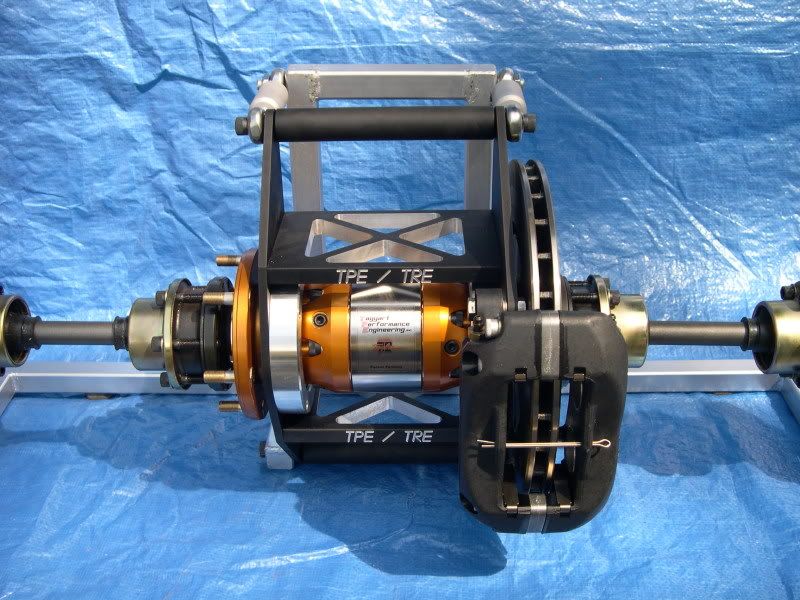

And these are the rear diff units I was thinking of using for our turbo 'Busa powered hillclimb and track car.
Web site here:
http://www.tpe-inc.com/index.htm
