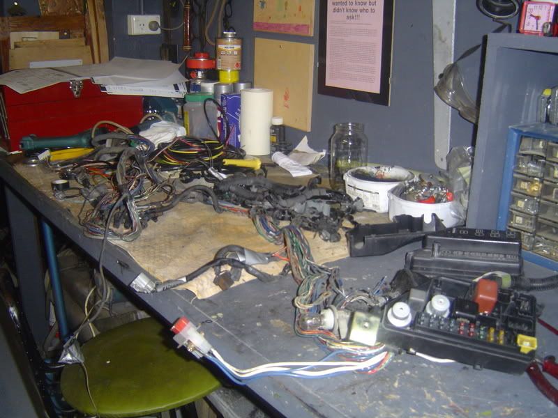

This is the front starlet loom with ABS and AC circuits still in.
This is the same loom without the ABS and AC circuits and re-taped. Rad fan circuit modified to stop the fan from running constantly (removal of AC causes this) Wiper motor and washer bottle, lights and indicators and of course the horn.
This is the next section of loom to be pulled apart and worked on.
Dan
