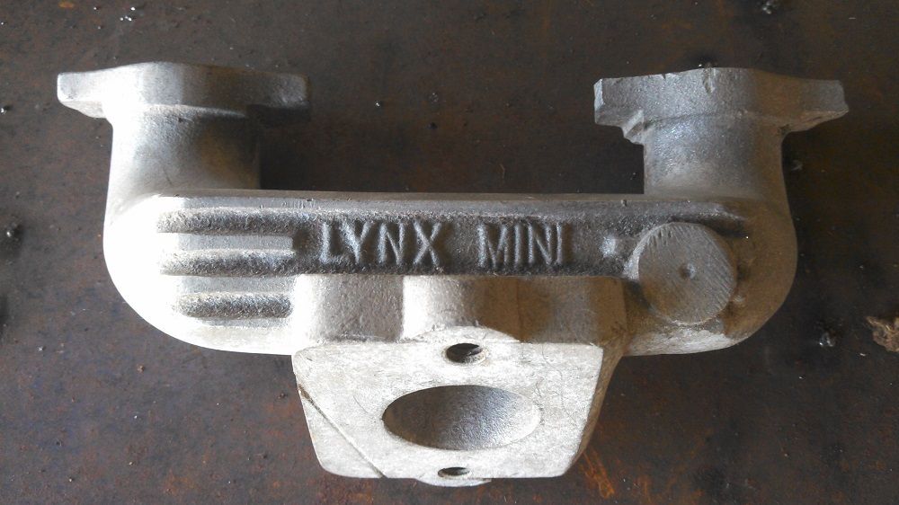

PostPosted: Mon Jan 07, 2019 6:41 pm
Joined: Fri Oct 06, 2017 6:39 pm
Posts: 191
Location: Perth, WA
I purchased a lynx manifold online similar to this, thinking it would fit a HS6. When it arrived, I measured the inlet and it's much smaller than 1.75", it was closer to 1.25" to suit a HS2...
Is the manifold shown here the same casting but just ported to suit a HS6? Or are they a different beast?: viewtopic.php?f=2&t=87235
Pictures attached of the one I bought:
