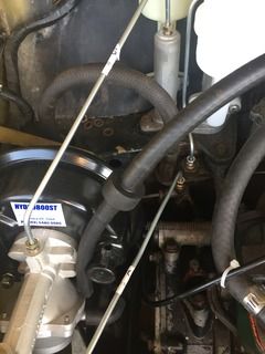

I looked at all the pictures of the original booster installs and they do not have the check valve. Do i need it or not?
Thanks, what size is the original vacuum hose?
1973 Clubman GT - YG2S8 1637
PostPosted: Wed Sep 05, 2018 11:13 am
Check valve is the elbow into the booster. Yes it's needed. Hose is 3/8 servo or vacuum hose.

Can I order the right brake booster vacuum hose? mine seems tight getting into the booster end connection
PostPosted: Thu Sep 06, 2018 4:19 pm
I just bought 3/8" vac hose from Blacktown Auto spares. Fitted my PBR booster fine. Not sure with the Lockheed booster, as my MK 1 S went years ago. Measure the fitting.
