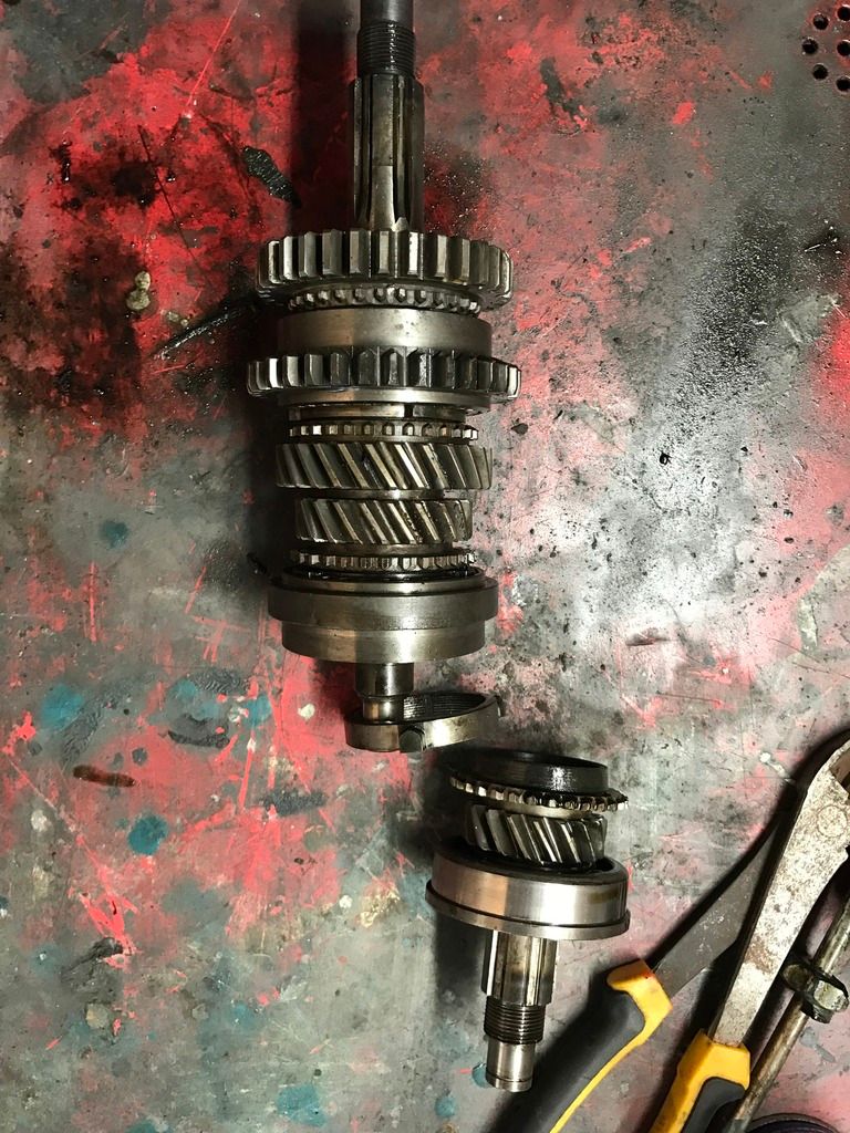

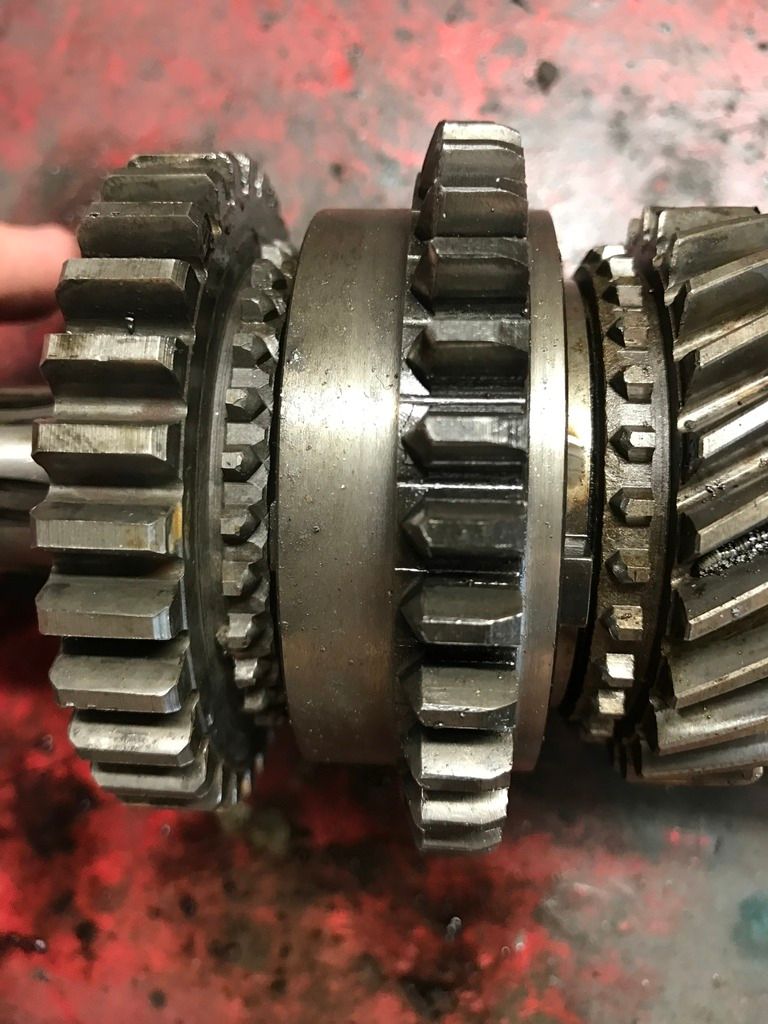

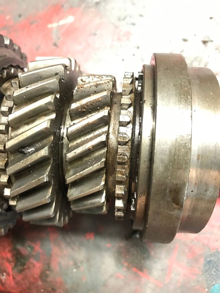

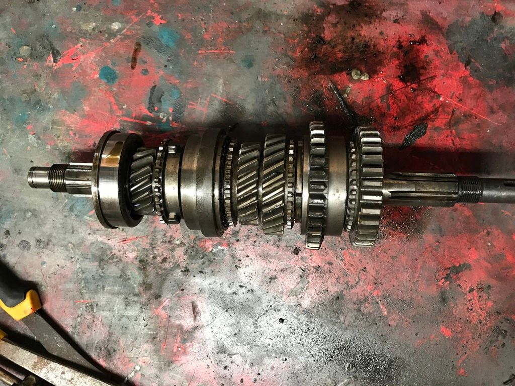

What about a photo of your main shaft showing 1st/2nd syncro hub so i can work it out
1970 MK2 Cooper S

Thats a bit personal! :D
I'll take a pic sometime today.
Aaron

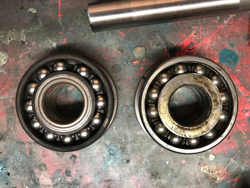

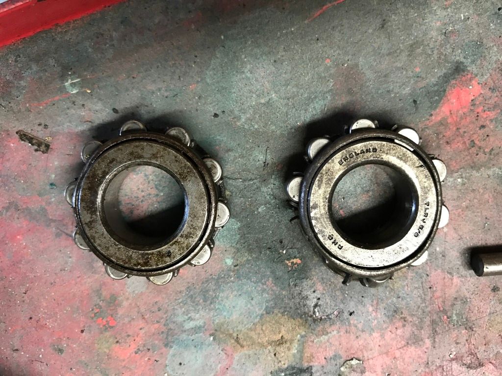

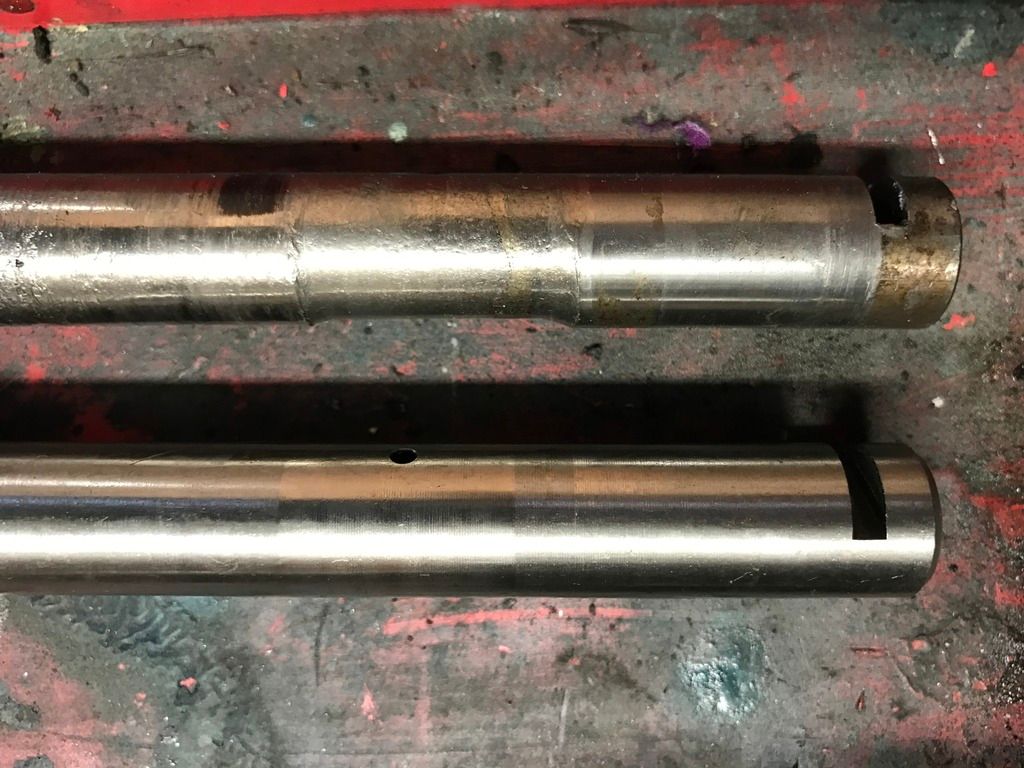

LAYSHAFT IS STUFFED... SIDE BY SIDE WITH A NEW ONE.
DOUBLE ROW ON THE RIGHT IS STUFFED, BEARING CAGE IS BROKEN. SIDE BY SIDE WITH AN OK OLD ONE
SIDE BY SIDE WITH AN OK ONE AND THE STUFFED ONE...

Thanks for the pics
It looks the same as mine at the 1st/2nd syncro hub
I find it strange why there is so much play there compared to 3rd/4th

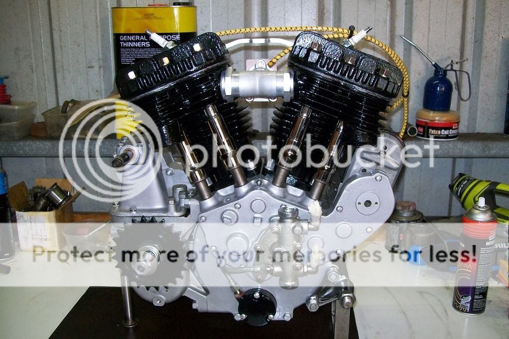

My main work has been the restoration of Vintage Indian Motorcycles
I do everything in house including cylinder boring and honing to Alloy welding, etc
