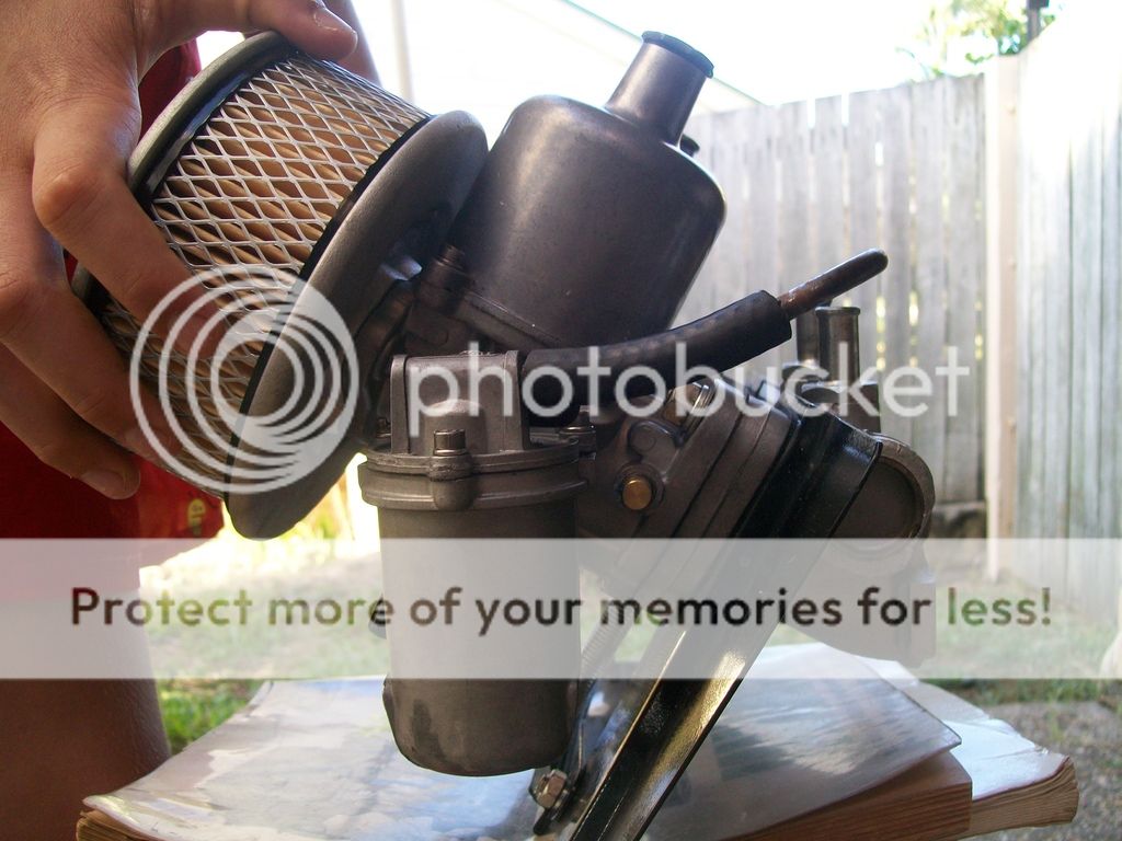

Here are my carbs
Just wondering if the spacers are causing the problem

PostPosted: Tue Feb 28, 2017 3:28 pm
your air filters will most probably hit the fire wall before fitting on, they`re very deep
& with "central hole" type filter-base-plates, makes for hitting firewall quite normal
usually offset base plates are needed to lift the filters up, away from the fire wall
PostPosted: Tue Feb 28, 2017 3:44 pm
Posts: 4501
Location: Wollongong, NSW
As theminiman has said (and you can see on the filter backplate drmini has above) the holes are normally offset to the bottom edge for more clearance in minis. Your filters would probably work for an MG/Sprite.

Your HP filters look heaps deeper than mine. Maybe you've just got replacement filters that are a bit too deep.

Good photos, and a really nice set up set of twins. - You can see why they have a following,, they just look the goods.
not sure if this is a goose chase, but to my inexperienced eye your float lids don't look like the typical HS4 SU ones - your fuel turret( for want of a better description) is cast where most SU HS4 type fuel connectors i am familiar with have brass sticking out. ( i couldn't quite make out your AUU numbers on the top of the lid..... but it may be worth checking against sucarb.co.uk to find out the model...... i am thinking if the lids are different then the floats may be different too - and there is not a lot of room. AS i said could be a wild goose chase based on my inaccurate knowledge, but i leave it out there for you to consider.
Your spacer next to your heatshield, looks about right - needs enough space to lift to clear extractors but not too much horizontal push to foul firewall - check with others, and Doc from memory- i think 20 or 25mm is the go. When i ran twins in a rod change engine, i installed an extra engine steady underneath, for fear of fuel bowls making contact with firewall as the engine 'rocked'. Cheers Darryl
