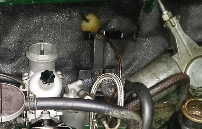

Hi Bill, Can you confirm if this black T piece on my car is the one with a valve in it?

gtogreen1969 wrote:
Bill B wrote:
Australian minis only had a 1-way valve on the hose at the bottom of the bottle. The valve has barbs on both ends, so check that it lets water in to the hose but cannot drain back.
We fitted an aftermarket setup recently which wouldn't work - turned out the spring in the valve was too much for the pump pressure.
The black "T" piece in your photo looks like it is a 1-way valve. The basic "T" piece doesn't have the valve housing. I don't think is is original - if that's what you are getting at.
Mini Spares shows GWW515 as similar to the one in your photo (although in white plastic) for 1992 onwards cars and I don't have any knowledge of these.
I think the original Aust. minis had a locally-made valve in the bottle (like M/S GWW504) but listed in Oz as AYD9065. It is what is in my K and S.
I'm sure any of these will work although some might be better at stopping drain-back.
Thanks for the photo - I am assembling my wiring and speedo soon.
