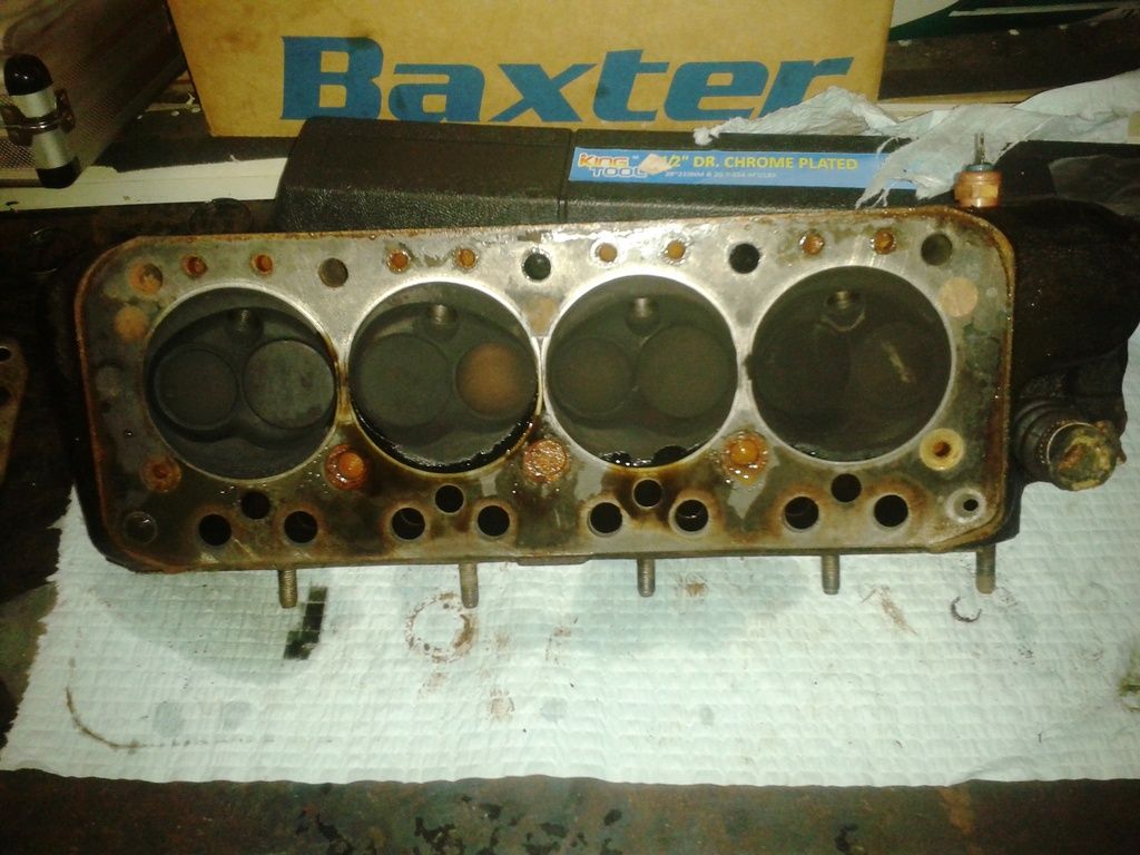

I was going to say, endoscope, you guys make it sound so easy! When my head came off the exhaust valve, seat and port was completely covered in 1/2mm of black soot. There's no way you're going to be able to spot a hardened valve seat insert... unless your endoscope comes with a scraper attachment to scrape some carbon buildup :lol:

Don't believe me? Here's only a small portion of what came off my head and mine wasn't blowing any smoke or even using up oil.

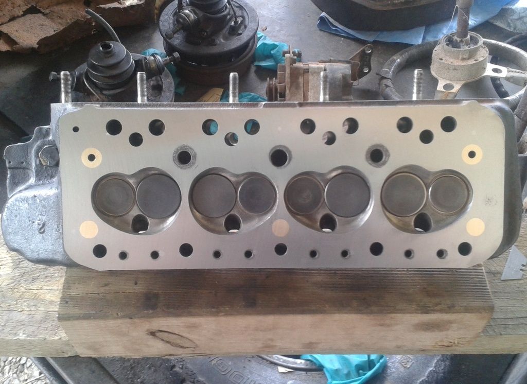

Here is a before and after of a 12G940 I did on my last car.
Here is a close up of the inserts for the exhaust valves. The seats standout when it all cleaned up but you need a good eye if there is carbon and soot.
I would be looking at pulling the head. It is a pretty easy and cheap job on a mini and you can get so much information about your engine condition from doing it.
But getting back to your original question your valve guides are probably worn and the valve guide seals have probably gone hard and are not holding tension on the valve stems.
