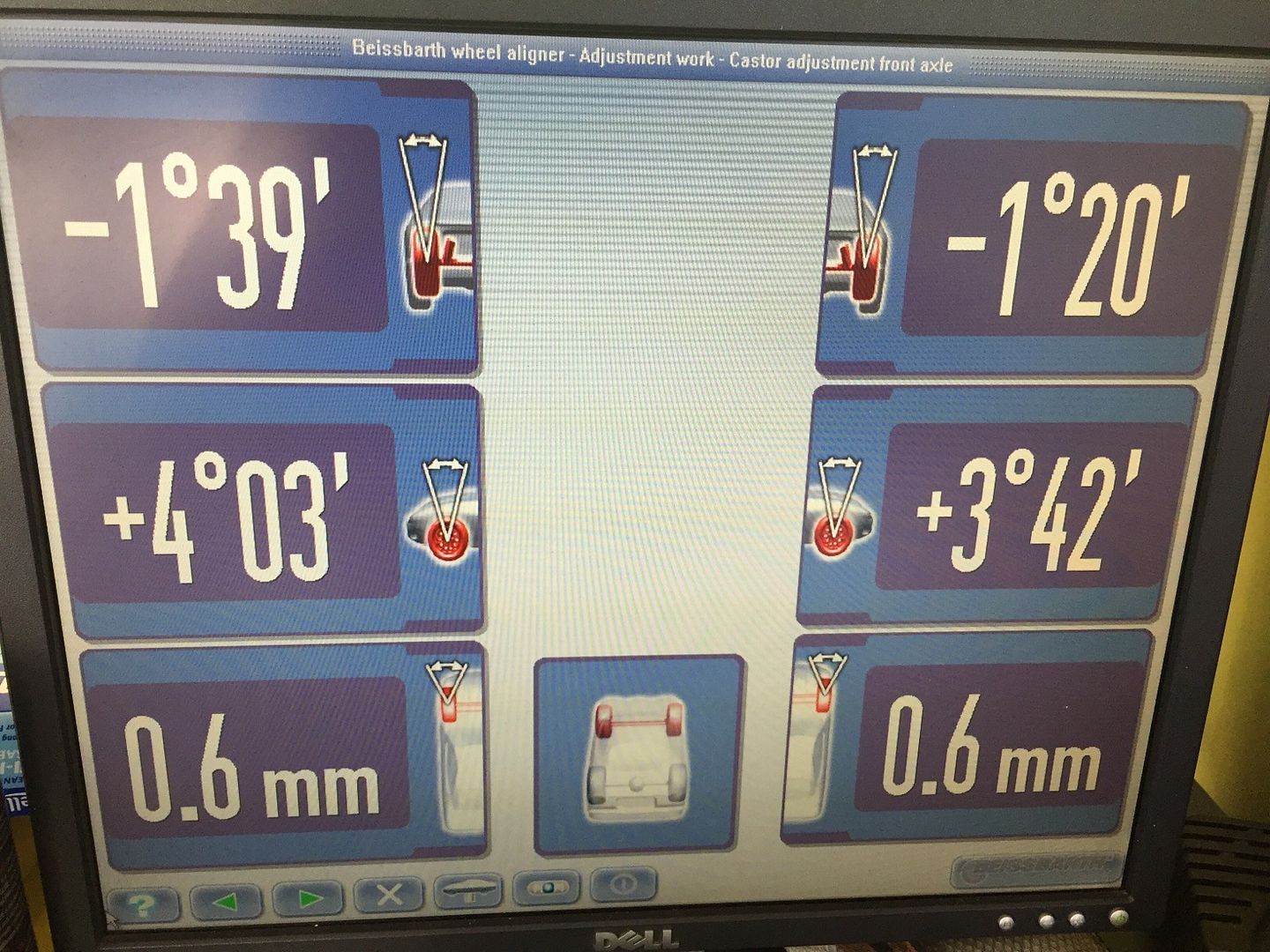

Here's my front alignment. This has 1.2mm toe in.

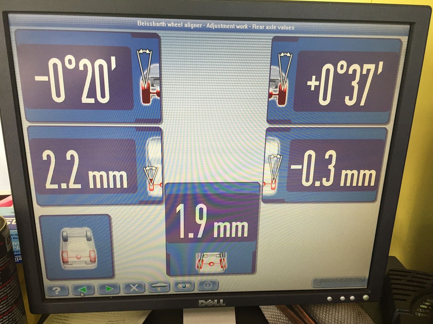

This is the rear
I then filed/ground the rear brackets to equalise rear tracking and increased camber knowing what I had already.
10" wheels with A008's
Love the way it drives.
Has fully adjustable front suspension and that allowed them to set it up to what I wanted.
