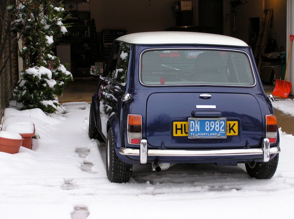

165s on 6" Minilites...
IMHO A-Jets are wet weather tyres; where they work extremely well - until they get past half worn.... In the day the rubber was soft ..and with the heavilly siped tread they were (IMHO) a bit squirrely in the dry. Great when it was p*&(ng dpwn...
The new ones are very sensitive to tyre pressures. Once we had that sorted, they worked quite well.

Thanks guys, looks like it's going to be Yokies. Gotta make up my mind about the 165's on Cooper S steel rims fitting under the guards without flares. Don't really want to use 145's. I do have a set of michmatch 145's in michelin and kumoh. Maybe put them on for the roadworthy, then switch to the 165's.
By the way, that's a nice set of wheels Ian. Nice blue.

Depending how picky the examiners are, 165 008s on S rims will fit under non flaired arches... with juuussst a smidge of sidewall poking out.
Yes, 8982 is a interesting toy.

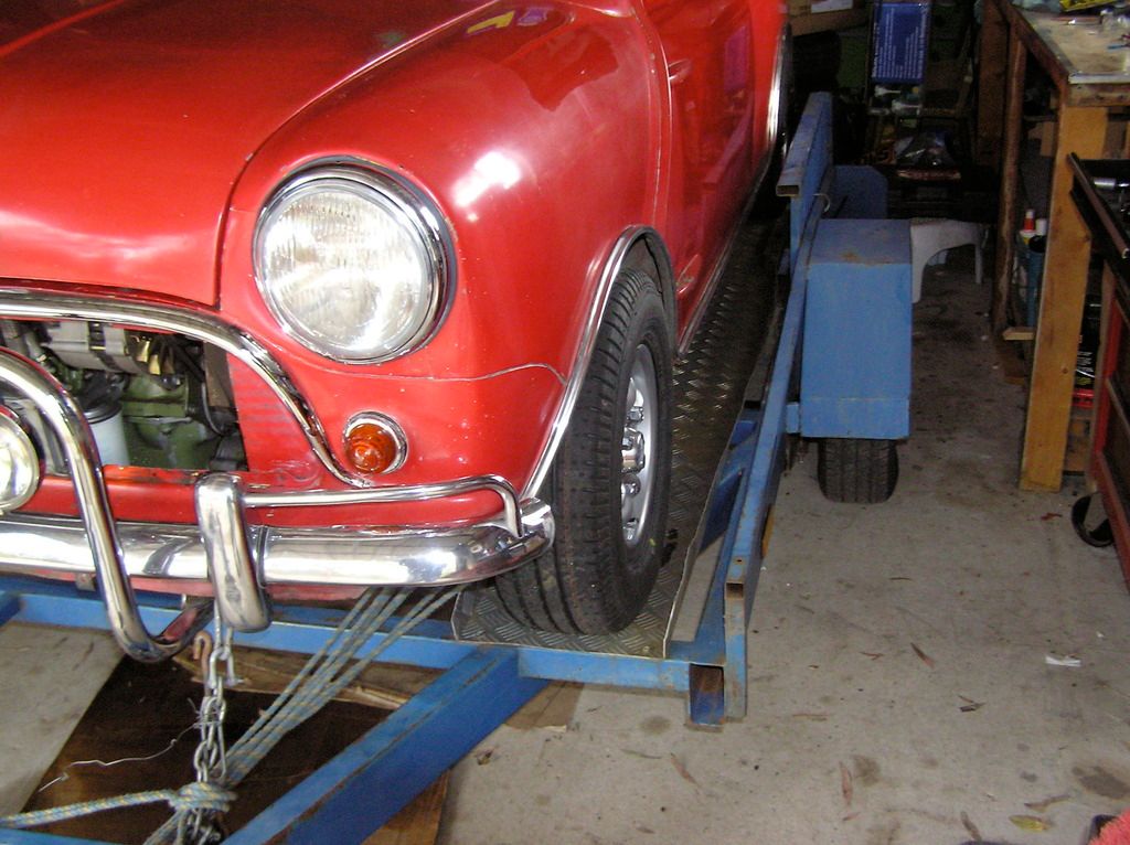

165 008s on S wheels, no flares.
A bit of side wall pokes out, but not so you would notice.
I've been left alone by the law so far, but the car doesn't get out much these days.
