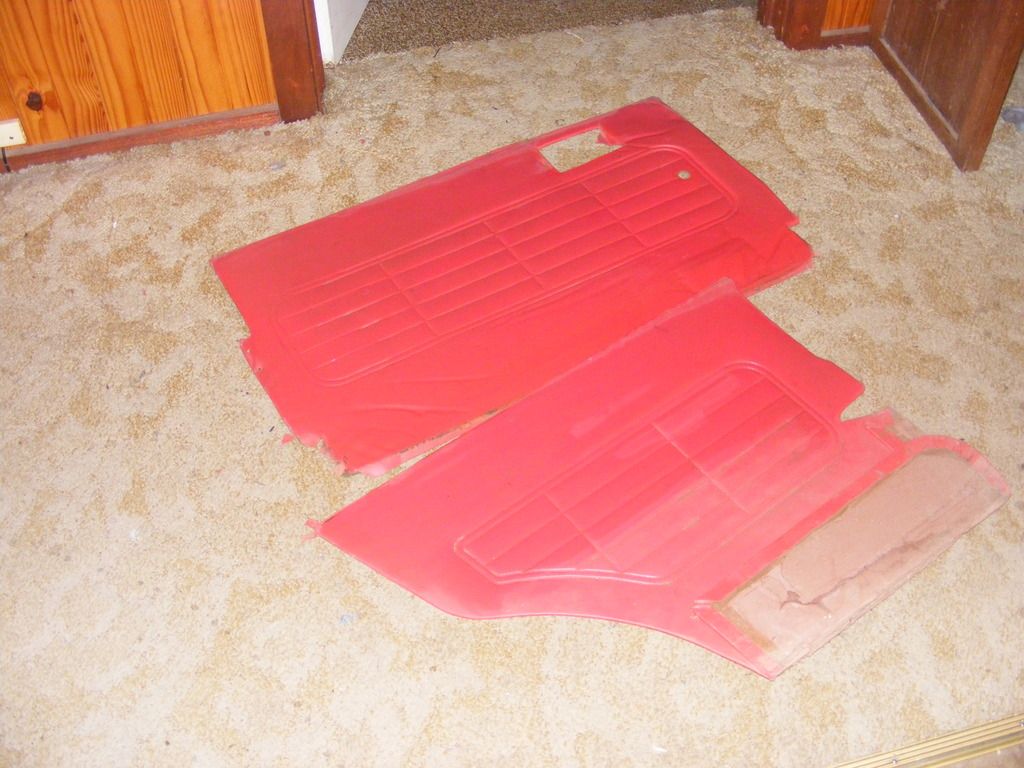

Red Clubman Cards, Left and Right. The Door Vinyl would need to be put onto new cards.
Are these any help to you.Image

I hope this isn't exactly a highjack of this thread, but…...
What material can "new cards" made from?
The original red, compressed cardboard looked cheap but worked well if not constantly soaked.
The usual modern offering is a black, bitumen-looking card but it warps easily and does not fold without cracking.
Does anyone know about a better material?

I used masonite when I did mine, it doesn't fold but they seem to hold their shape nicely and will be tougher than cardboard, more resistant to water to I'd bet.
I was tempted to use a thin 3mm ply as well.
