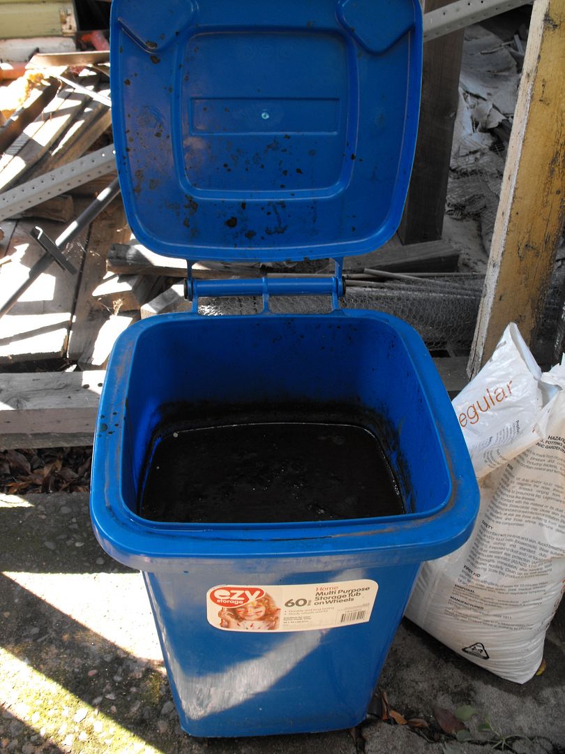

I've set up a molasses bath and have cleaned up a few rusty mini bits , i pulled a rusty flywheel out today ,( been in for 2 months ), hosed it off , dried it , i'm impressed . I also pulled a crank out that had been in for the same time , cleaned up nice .

I've been using vinegar baths but will give molasses a go. What ratio of water to molasses did you use?

Approx 50/50 , mixed the molasses (came in a 14 lit tub ) in a bucket with hot water to dissolve it well , and then topped up with water .

As for rust removal I have been using washing soda and a battery charger, it is a lot quicker but yours looks like a much cleaner result, where did you get your molasis?

You can buy molasses from any horsey supplies shop, or stock feed merchant.
