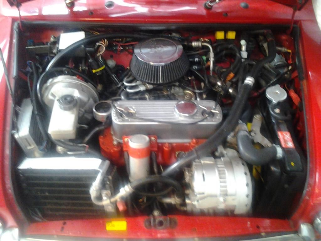

PostPosted: Tue Dec 16, 2014 12:49 pm
Rover Cooper
Posts: 2401
my setup
