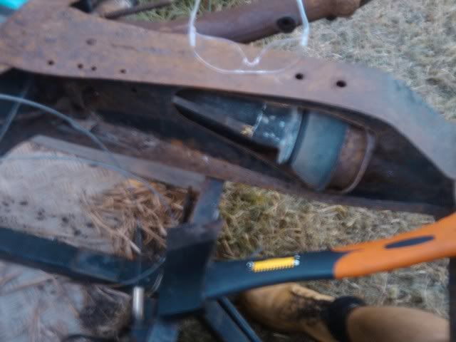

Indeed. Mine came apart:
My preferred removal tool

awdmoke wrote:
TheMiniMan wrote:
Yes, belting with FBhammer & big chisel is the go to get the strut to separate from the donut
just keep being persistant at it cause they will come aprt, just keep at them
I had a front trumpet break as well when removing it from the doughnut. But on inspection it was badly corroded, so probably a good thing it was replaced with hi-low.
I place a piece of wood on the flange of the trumpet where it goes into the doughnut and belt it there.
If you hit it half way along it could shatter.
