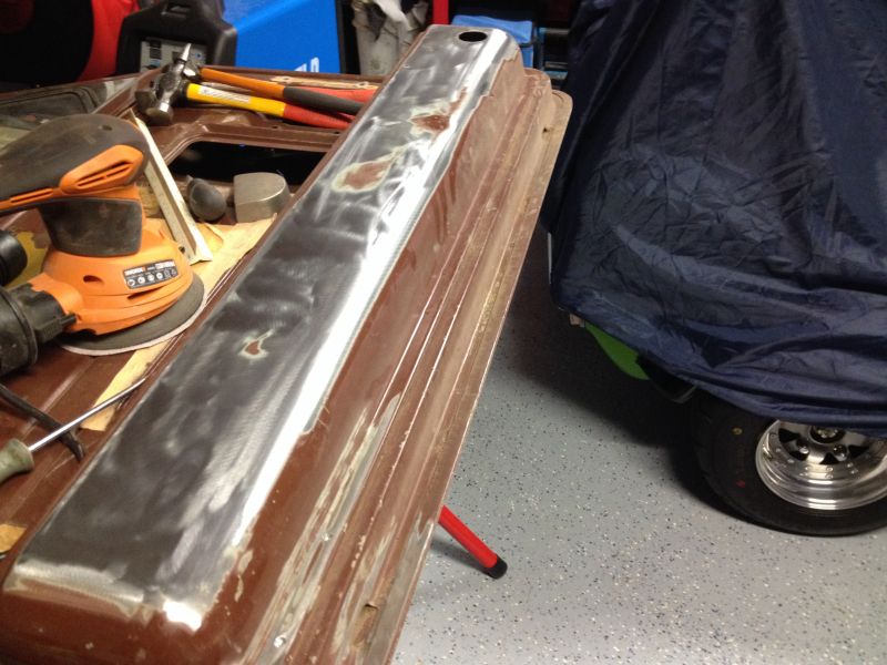

davem wrote:
Weird gently prying with a screwdriver there isn't any spot welds along the bottom only at the corners and sides, must of been some of that bmc quality control,what size drill bit did u find the best?
tbh I can't remember I just grabbed it out of the toolbox :roll: but it was a spotweld removal bit not a drill bit, you will most likely punch holes straight through if you use a normal drill bit. Even using a spot weld bit I still managed to put holes through as you can see in the pic with the pocket removed
PostPosted: Mon Aug 25, 2014 7:31 pm
Posts: 1125
Location: Barossa Valley, SA
Here is another set of pockets so you can see the weld pattern is not uniform it really depends on what type of day the guy is having I guess?

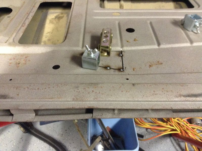

Ok round 2! Practice piece tell me what you think good and bad, the patch slightly became convexed, l only noticed this when l finished the patch with a straight edge. What caused this to much heat or shrinking of the metal? I managed to straighten it out with a dolly
Thanks again to everyone which has contributed to this thread thus far. :)
1993 R32 Nissan Skyline GTR
PostPosted: Wed Aug 27, 2014 8:29 pm
Posts: 1143
Location: Tassie
The heat will make it move all over the place.

PostPosted: Thu Aug 28, 2014 8:27 pm
Posts: 1347
Location: Wellington,
An old trick I was taught at my car resto course was too weld then tap with hammer weld tap etc all supported by a Dolly.
This shrinks any expansion caused by the heat from the welder.
Also let your welds cool to the touch before you do the next one.
Also you can put a heat spot in the middle of the buldge then tap with a wodden Mallet supported by a lead dolly
Its a buldge on the other side
Also what happened to the panel is normal when welding panel steel. It gets worse with small patches.
If you could tap it flat then you did a good job of controlling the heat
When you mean tap down the patch after a weld do you mean dolly off or dolly on? Thanks again everyone for the encouragement and advice keep it coming
PostPosted: Fri Aug 29, 2014 8:15 pm
Posts: 1347
davem wrote:
On dolly. Weld needs to be hot when doing it.
Also when welding start on one edge weld. Tap. Go to the opposite side weld etc.
The trick is not to hard to split the weld.
