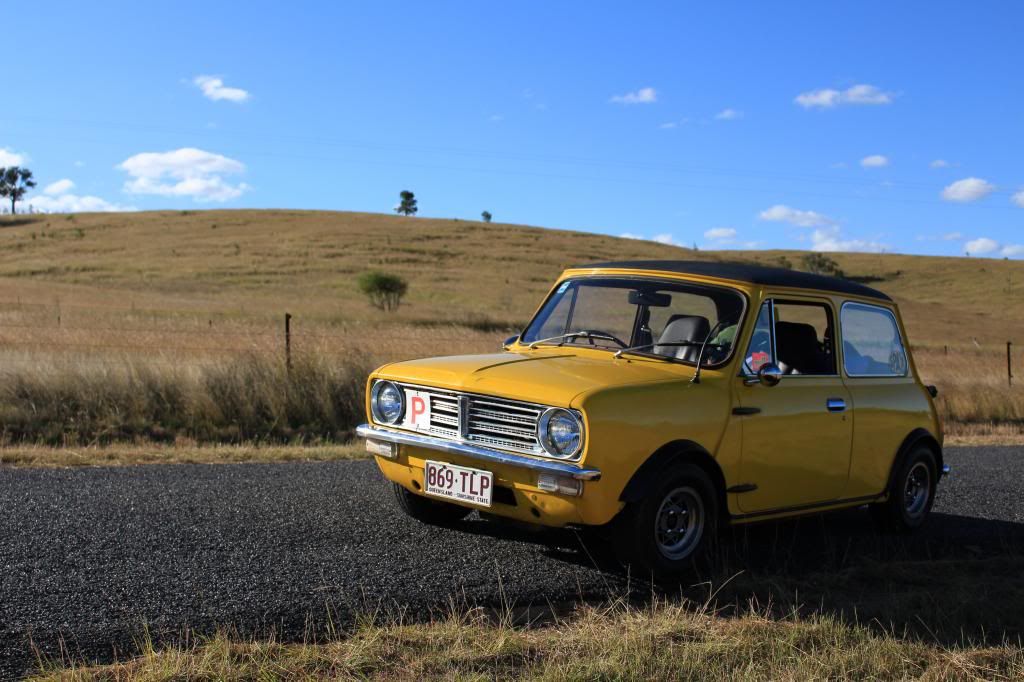

Anyway, here it is!
Havin fun at Bathurst. Well, as much fun as you can have with a 60kph limit...

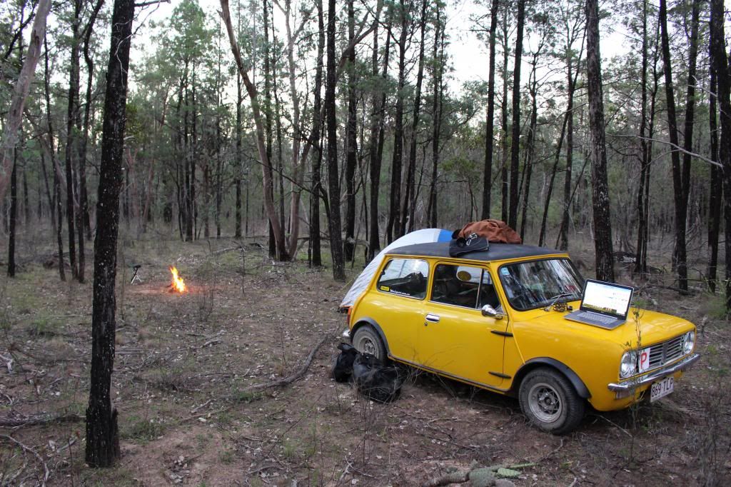

On my road trip from Brisbane to Canberra. It was a rough day.

What a beast!
