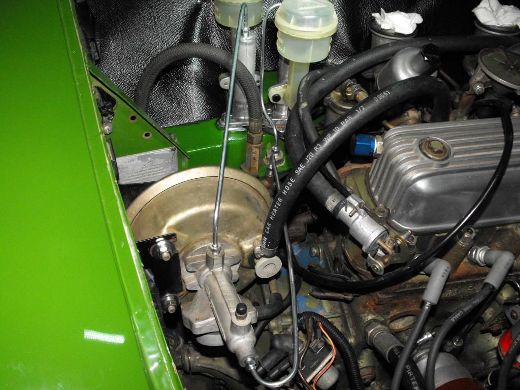

Does any one have a picture of how the brake booster pipes run.
Looking for a tidy setup
1275gt booster into a round nose mini.
Seeking ideas
Ta Kiwiinwgtn

This would be a good pic of what Wazza is talking about.
But you're not after the British Mk3 Booster are you?

Using the oz 1275gt booster like the one in the pic.
Which means it's a MK II Cooper S set-up, as they used the PBR VH44-J booster. In the following picture the pipe that runs from the nose of the booster to the three-way connector on the firewall should be lower (i.e. the curve as it exits the booster is parallel to the ground and the pipe runs under the vacuum hose then curves down to the three-way). The top pipe is the correct profile.
If you would like those two pipes made to original specification on the BMC Australia factory drawings let me know.

winabbey wrote:
The PBR booster was VH44-JA; J= higher line out pressure; A= vacuum canister turned 180 degrees to fit on RH guard.
Does this also mean that the MkII does not have a bracket holding the nose (like UK Lockheed) as in photo and does not have a clamp holding the inlet and outlet pipes?
That's right, no need for the bracket on the nose and no clamps on the pipes.
PostPosted: Mon Aug 25, 2014 4:21 pm
Posts: 6751
Just to reinforce what Morris 1100 has said, the photo of Wazza's build as posted by Mick above is not the factory method of installing the PBR booster. This was mentioned in Wazza's build thread. It shouldn't cause problems being done that way, just an overkill given the correct mounting bracket is being used. It stands out as being different to anyone looking for a factory set-up for a concourse car.

winabbey wrote:
I would appreciate a pic of the factory pipes.
