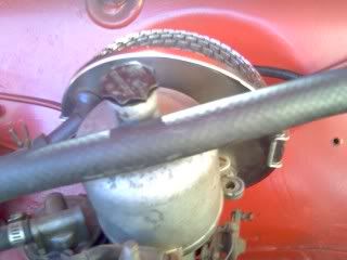

does anyone know how to drain oil from the dashpot on my 1 1/2inch carby.
This is my dash pot:
where can i drain a little bit of the oil?
Now the reason i ask is because my mate put a bit more oil in it and now my throttle is VERY VERY sticky.
So id like to be able to drain just a little bit to get the pedal feel right.
Cheers, Rhys.

Grab a syringe and suck it out
PostPosted: Fri Jan 27, 2012 12:06 pm
Posts: 2611
Location: werribee vic
I use a cut off drinking straw to fill and drain the dash pot
To take some out just put the straw in then put your finger on the end withdraw and take your finger off once its in a container
I mark mils on the side so I know how much I,m adding or taking out
PostPosted: Fri Jan 27, 2012 12:09 pm
Take off the air filter and push the piston up all the way. If there is too much oil the excess will be forced out the vent hole in the lid. (a bit of rag over the hole will soak it up)
If no oil comes out it is not over full.

There is no ideal oil to run in them, you run whatever works best. My 1275 with twin HS2's like ATF, yet my van with 1100 and single HS2 will only run well with engine oil.
PostPosted: Fri Jan 27, 2012 12:34 pm
Posts: 2276
What exactly do you mean by "sticky"?
Because the two things would not be related. The oil in the dashpot is not a lubricant. It'is a damper for a piston that alters the mixture. It stops the piston from rising too quickly when you accelerate suddenly and causes a change in mixture.

Sorry i didnt put more detail.
When i accelerated my pedal would stop kind of like jamming up then id have to really stomp on it to unstick it.
Ive drained a little oil and it feels better so ill take it for a burn.
Could it be caused by an over tightened accelerator cable?
