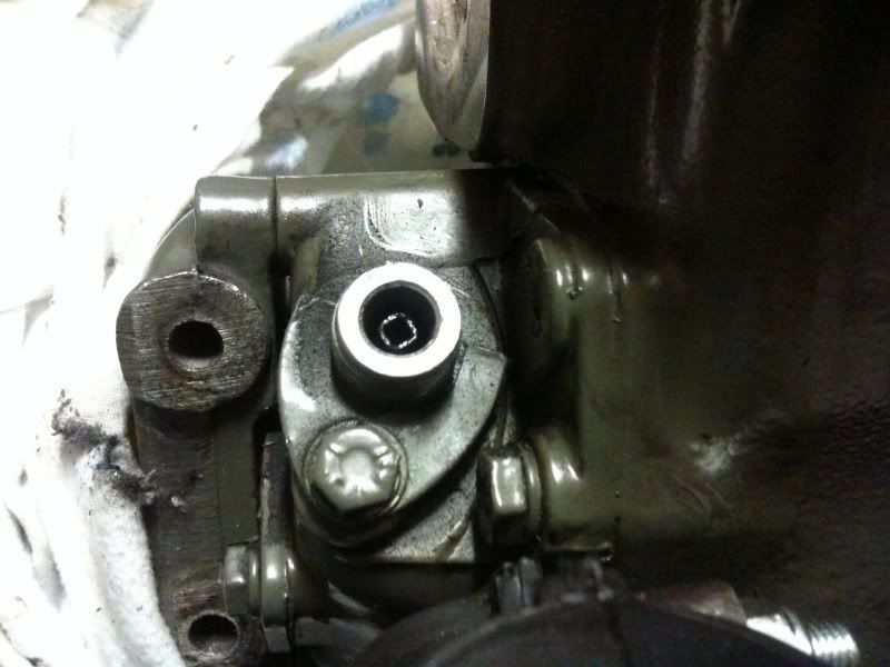

I thought a pic might help. This is what you are playing with.
You can take out the 7/16th AF bolt and withdraw the assembly. But I think the problem might likely be that the cable has not located into the square shaped hole you can see in the image.
I have a couple of examples where the square thing is now round, caused by the cable not being far enough in and wearing it out. I'd expect the only way it wasn't far enough in was because someone didn't do up the knurled nut properly at both ends
