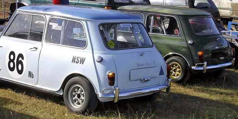

DRB33N wrote:
Half cage only, top roll bar must be 90mm away from the highest point of the seat, no bars obsecuring the rear window, must be engineered and will be registered as a two seater only.
Would the bars shown here be considered as obscuring the rear window?
What about a single rear bar in the middle?

Minimic wrote:
That car seems to be unregistered and having bars bolted to the rear shelf seems silly to me, most half cages have the top bar and two side bars that go down the rear arches. As for rear vision, so long as it it not blocking or obsecuring your view. Your best bet is to still consult the engineer.
