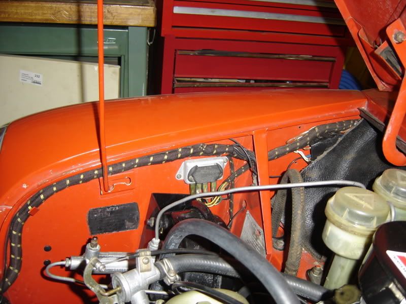

I have a bare 850 shell and a brand new wiring harness.
This is Good
BUT I dont know where it runs to, ie which holes to poke which bits through???
Does anyone have any pics to help me out with routing this thing?
REgards
Smarty 8)
68 Mini
70 Moke
PostPosted: Wed Jun 06, 2007 5:49 pm
I can take pics in the morning to help , where do you need them of specifically , just anywhere the harness goes near the body ? PM me your email address and I'll email a stack of pics .

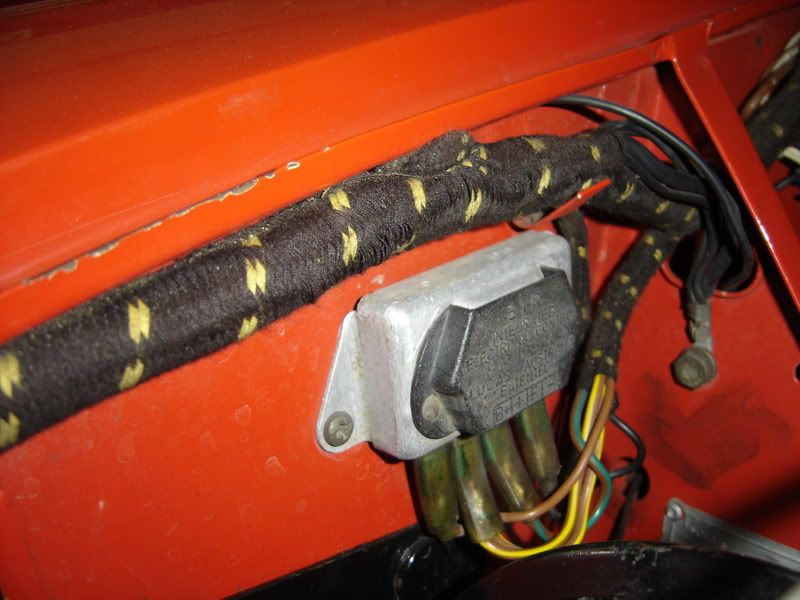

PostPosted: Wed Jun 06, 2007 6:22 pm
These may help with the routing, you will have a large generator voltage regulator behind the gusset however, but the routing is the same. note the ground wire common point screwed to the gusset. If you have one of these, it might be a good reference point to start at.
