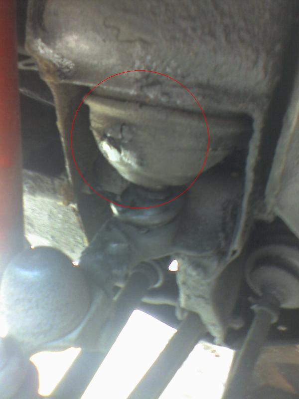

Whilst adjusting my brakes today i noticed my suspension had a hole in it, or what looks to be the suspension or a cover???? is this the hydro bag or jus a cover??? (sorry couldnt find the digi, had to use mob)
its only soft so i hope its only a cover :?

Its only a cover. I don't know if you can get a replacement, so I wouldn't worry about it too much.

And a real PITA to change. Let sleeping dogs lie :wink:

phew!! :) coz it was the same on the other side

That's considered good condition :lol:

They are easily available new, you just need and excuse to release the pressure in the system, remove the top ball joint and replace by sliding over!
I know of at least one guy who does without them completely so he can see if the knuckle joints are in place correctly in the hydro bags.
