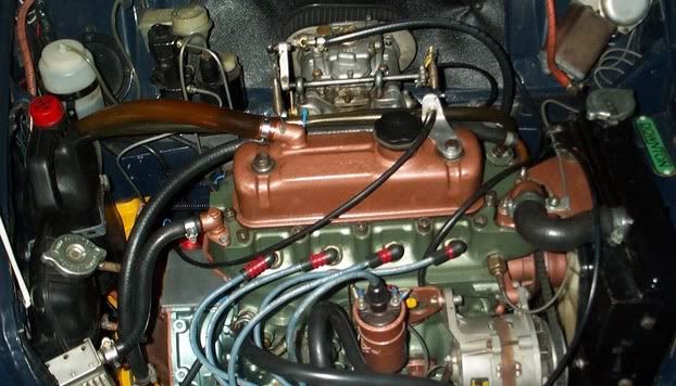

PostPosted: Fri Feb 09, 2007 9:19 pm
Online
Posts: 39750
I run a PCV on the road, but for track days I bung the catch tank on.
You can't run both, it won't work properly.
Reason I remove the PCV for track use at Wakefield is it sucks oil from the primary gear area on long LH bends at high RPM. Makes like JB007.... :lol:
Note it's a 1300 auto block, NOT an S... so no S tappet chest breather.
