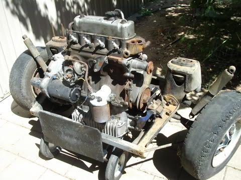

so yea pulled it out today with the subframe..first engine ive removed :D
engine number 9ya ta h14896
9 = engine size between 900cc and 999cc
Y = Australian assembled
A = Variation of power unit (A= 1st variant)
Ta = Std ratio remote centre change
H = High compression
so would this be any use of anyone? Would i be able to sell it, worth anything? etc. it must be "wow rare" :roll:

looks good
styres have seen better days

Early motor. (about 1965)
Late starter motor.
Late cylinder head (pollution head)
