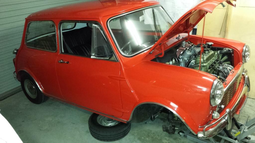

Put the old girl up to take the front brakes off. Time for a ball joint check/service and I've got a CV Joint dust cover that's pushing a little grease out. While I am there, I have a set of adjustable bottom arms and tie rods to install :)

Nice jack there mick
PostPosted: Sun Jul 27, 2014 9:43 pm
Its an ATV jack. I'm a bit of a convert to this unit. It starts out super low, it jacks the car nice and high, a spread load, and locking points to take the weight off the hydraulic ram.
I still use Jack stands, but not today, I have to play with the tie rods and they get in the way, so I've used the ATV jack's lock point.

I use 2 holden torana rims each side and a mini rim in between and a block of 4x2 timber between the floor and rim as stands around where the wheel is in pic
I find it safer than axle stands when doing a job like that and i can lift all 4 wheels off the ground if i have to with 1 holden and mini rim on top in each corner of the floor
Good for bleeding brakes with all 4 wheels up in the air and i use a steel 4x2 hollow beam the width of the car between floor and rims on the back
