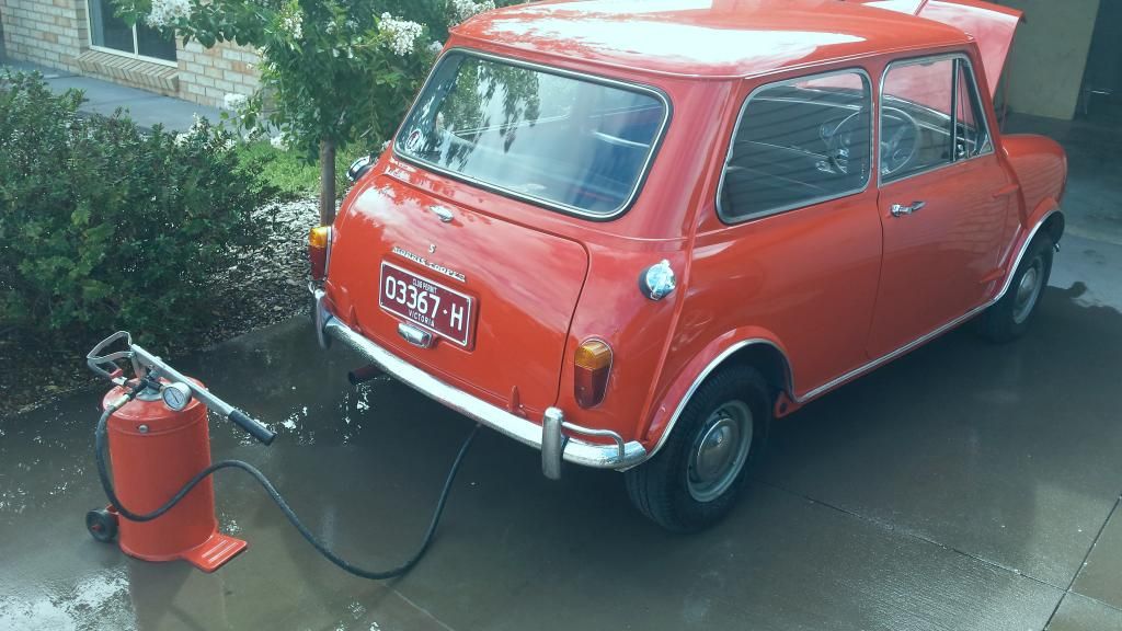

After helping John with his Mini K on the weekend, I decided I should keep the pump out and adjust my car up properly.
I haven't filled the suspension up to full pressure since it was first done in 2009, so I hooked the system up, bled her down and pumped her back up to the full rated pressure.
Now it sits as it should for the first time, with three finger well and clear under the front arches.
With all that however, I've just earned myself another wheel alignment...
I'm going to re-register her again in the local plates shortly. Better get these bits and pieces sorted out..

Doc...did you go slightly over-pressure? (330 say) then drive it around a day or two to settle, then let down to 3 fingers or whatever (don't you show those fingers to me :lol: )
PostPosted: Tue Mar 25, 2014 4:00 pm
I think you meant Mick instead of Doc.
No, I put it up to the height I was after directly, plus a quarter of an inch. I'll let it settle from there. As it is it sits on 300 Psi.
I have had it at 290 or 280 since 2009, so there wasn't far to go pressure wise, but the rear helper springs only start to really make a difference to the front height after 290 PSI.
There might be 40 pumps of my unit from empty to full, but 7 of these are between 280 and 300 as it jacks the engine off the ground.

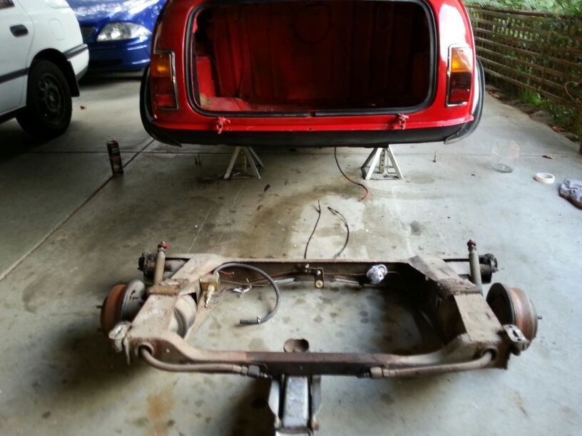

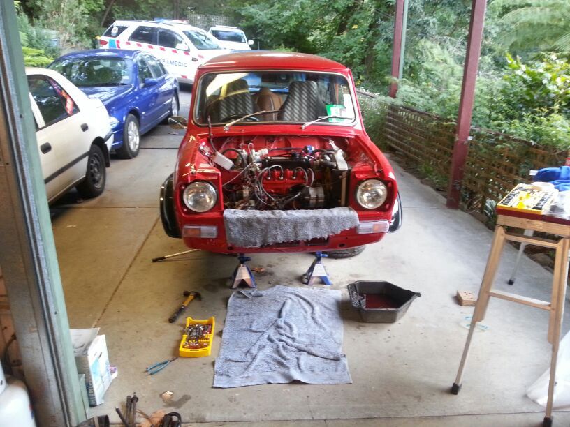

Started my Wet - Dry conversion this weekend. Yesterday i removed the motor, and today i managed to get the rear sub frame out.
Next weekend i'm hopefully going to pick up some new sub frames to build up, get the front sub frame out and start ordering new shiny bits 'n' pieces!

Pulled the front subframe apart for Jim to come pick up now to do the rear.
Did you do yourself a mischief working on the mini JimL, the paramedics in the back ground is worrying....
PostPosted: Sun Mar 30, 2014 8:50 pm
Posts: 307
Location: East Melbourne
Haha no, the old man is a paramedic. So at least if anything does go wrong I know help isnt far away!
