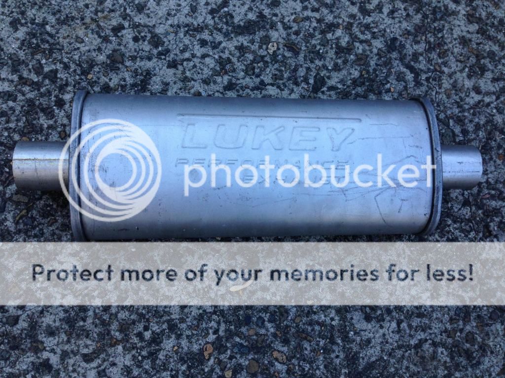

On the Lukey, it doesn't look directional, the perforations look identical from either direction down the middle. Can anyone confirm it is bi-directional?

Back in the day they were plain pierced holes and I don't think it mattered.
When we bought Barney the PO had put a 1-3/4" Lukey on (maybe was a different model) and the perforations were directional. With the muffler on backwards there was a noticeable power loss.
Try both ways before you weld pipes to it. :)

From memory the holes/perforations are straight in the tubing. Other brands like redback and berkley had a directional slot hole in them. With that particular lukey it shouldn't matter. Been 8yrs since I looked at one though!

Having another look, the perforations point toward the inlet or outlet depending on your perspective. Each end is a mirror image of the other, so I can mount it in either direction.

You want the perforations to point towards the tailpipe.
They should put a direction arrow on the damned things...
PostPosted: Fri Jul 18, 2014 10:15 am
Posts: 18888
Yes, that's what I mean. No matter which end you look in, it is the same.
Each half of the perforations in the pipe look toward their closest end.
So it doesn't matter which way you mount it, it will be the same result.
PostPosted: Fri Jul 18, 2014 10:19 am
Posts: 39762
Ah OK, the one we had on Barney all pointed the 1 way.

I have a new Lukey L-132 as well, not yet fitted. On the opposite side of the muffler to the Lukey logo on mine there is a directional sticker saying "ENGINE". I'll try and get a picture up later.
Mick, on yours the 'engine' - end would be where they've written the L-132 in texta.

My Lukey L-132:
With directional label:
Here's the Lukey next to what I was told was the original factory muffler from my 1970 Mk2 Cooper S:
As you can see there is a big difference in the size between the two mufflers.
Can anyone confirm that the larger one is indeed the factory muffler? Does anyone have a known original to compare it to?
Appreciate any help on this.

There's no sticker at all on mine, but I can't see for the life of me how it differs.
I'll go with your sticker direction, but it may be arbitrary as the orientation of the Lukey might depend only on how the squares of material were presented to the final welder for completion.
It might be the sticker is arbitrary too, to prevent stupid questions at the front counter from the apprentice. Ha ha :lol:
