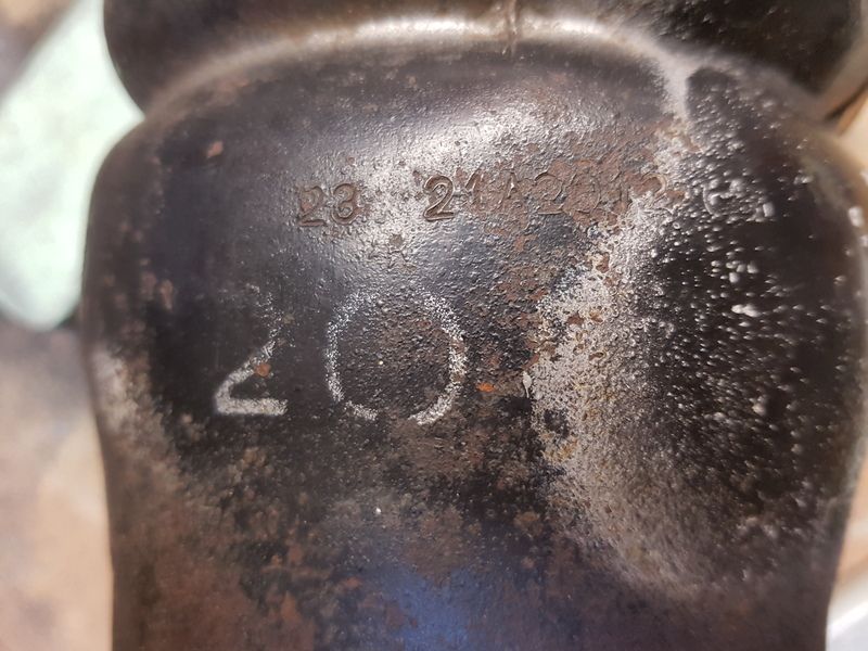

As noted i compared my old stuffed bag with a 21A2008 bag and noticed the cooper s bag the rubber section is moulded closer to the top of the metal body by about .200"
All i can see this doing is lowering the car for the same pressure compared to the 2008 ones
1970 MK2 Cooper S
PostPosted: Tue May 03, 2016 4:58 pm
Posts: 39752
No, the rubber cone bit is actually thicker, that is why it is closer to the top. Increases the spring rate.
At the same pressure, the car sits higher. I have 2 in the front of my wasaMatic.

Thats funny as i measured the bottom side and the rubber part was further up on the cooper s bag
Will have another look as the cooper s bag was a bit knackered on the bottom side

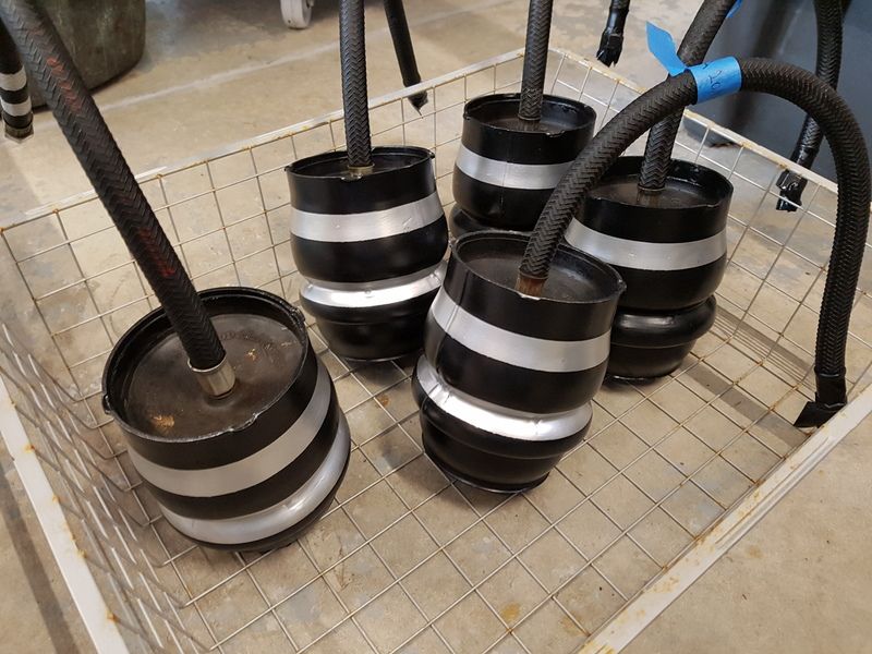

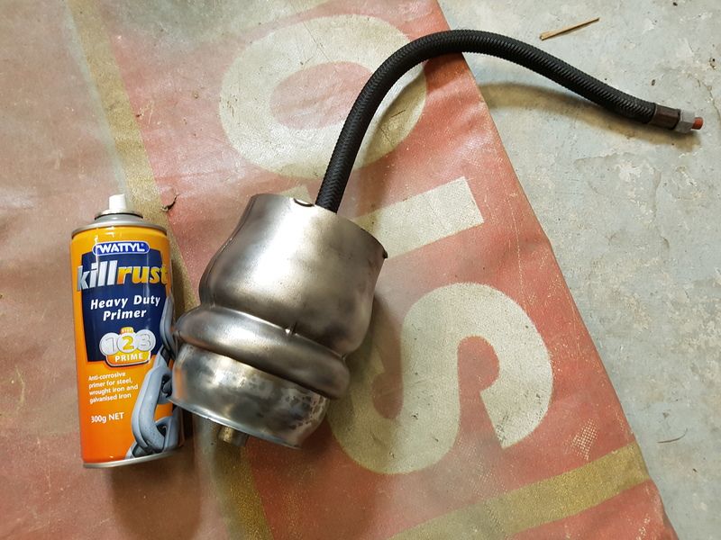

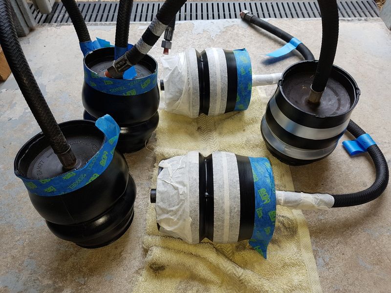

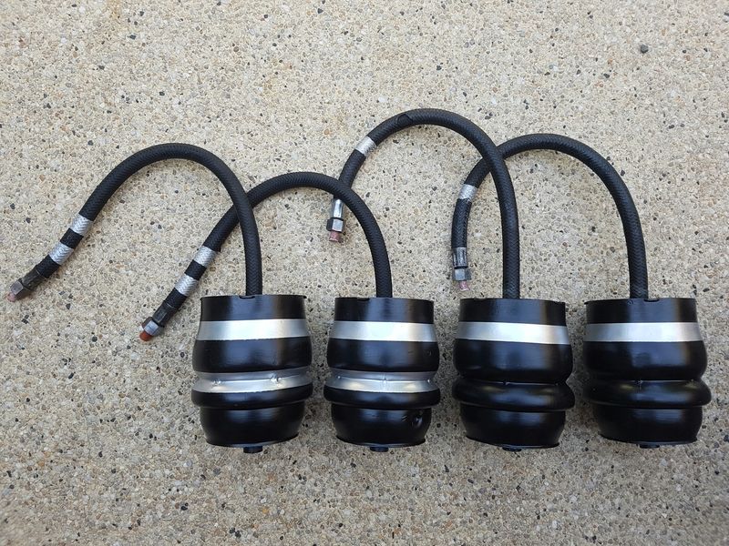

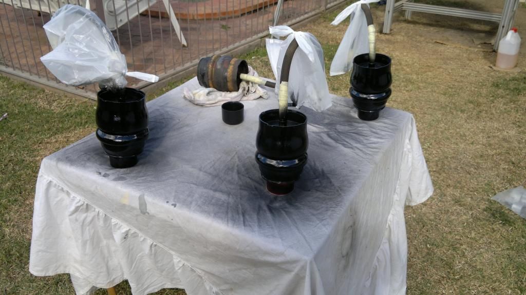

Spent today wire brushing paint off and priming hydro bags. What sort of black paint should they be painted? Matt - Gloss? Might as well do it close to original seeing how I have gone this far! I will paint the silver bands back on to the hose and body. I might even make a stencil to put the part number back on. Only took about 5 minutes to get paint off using wire wheel on bench grinder.

Hello Flute,
I paint all suspension "satin" (semi-gloss) black, including the displacers. I spray Dulux Interior Enamel house paint. It has lasted for well over 20 years in other cars.

I've used KBS Blacktop (chassis black) in both gloss and satin with very good results. I believe the satin is closer to an original finish though.

Freddo wrote:
Hi All,
Well it is probably about time for a "mini" update :lol:

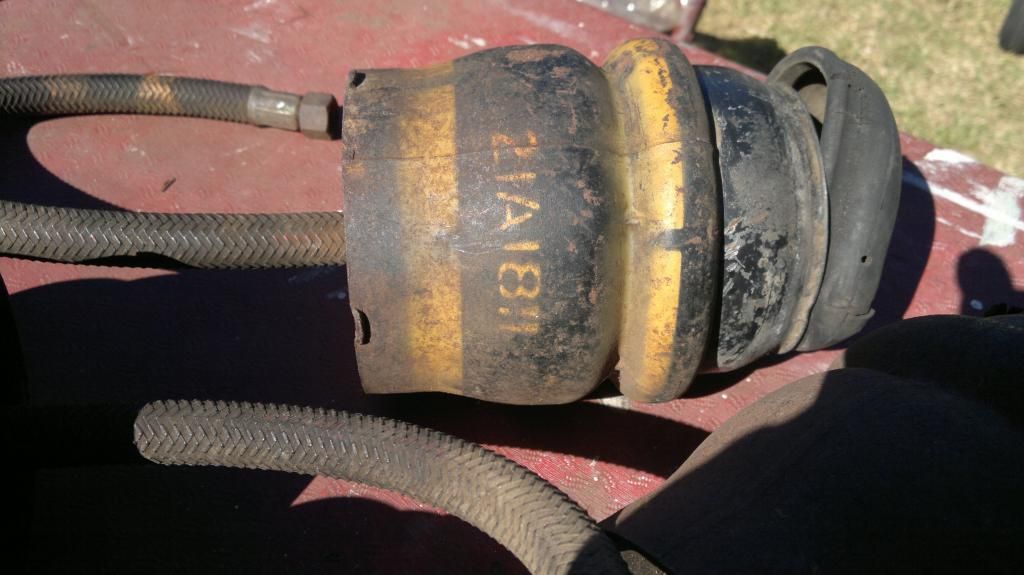

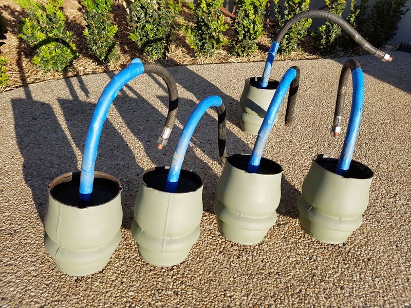

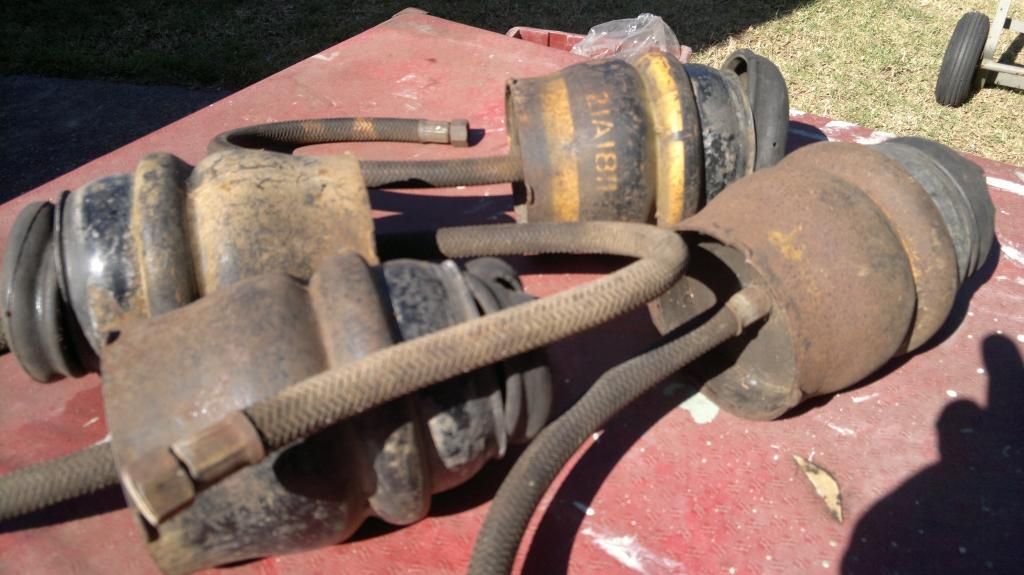

Finished my fathers Mk 2 now back onto my Mk 1. Been interesting building them side by side (almost) to discover how many differences there are between the cars. Anyway, been busy painting brackets and bits and pieces for the body and suspension and essentially bagging and tagging stuff and putting into a storage box ready for assembly.
Got onto the hydro bags this last couple of weekends...started with these
Pretty dirty and rusty but the real deal for the early cars

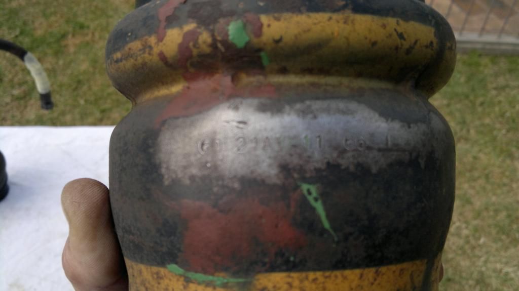

Funny that some other displacers have no part numbers stamped into them, these 4 do

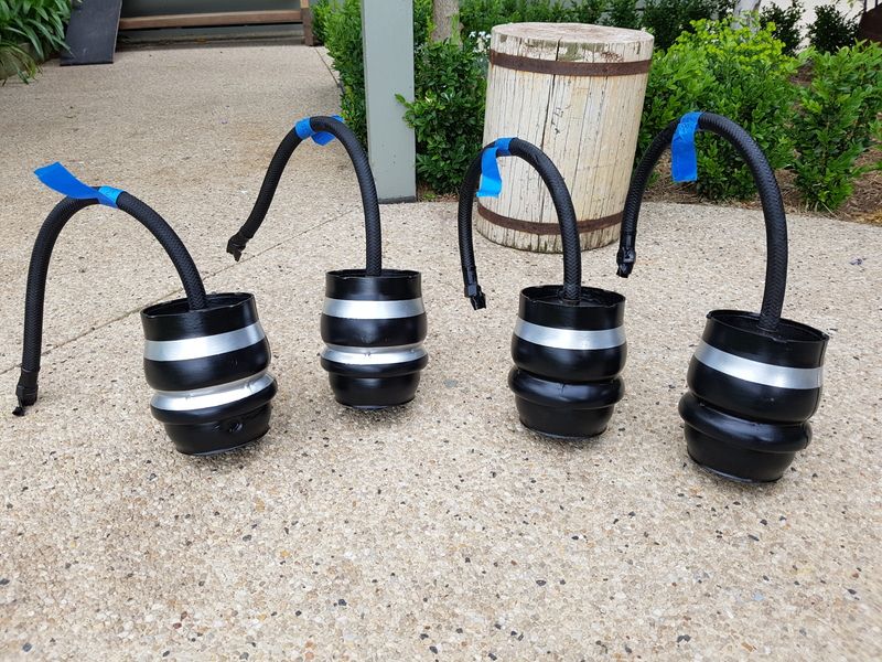

After cleaning them up and applying rust converter/sealer painting them was a breeze using the cap of the spray can as a stand
Will post the finished product after this weekend
Cap from a spray can makes a great stand for paining them

Very interested to see that better photo of the bands thanks. I thought they would have been rougher but looks like a pretty neat band which I hope to replicate. The part numbers may be harder to make two templates.

Not saying mine are great but here is how I did mine and I am happy enough with them. I haven't found anywhere that can make a stencil to put the numbers back on yet.
