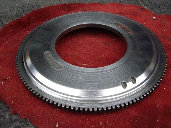

i`ve seen quite a few std factory "one piece" flywheels crack right through the guts/centre.
seen em open up like the grand canyon, I`m not "That" much of a fan of them after seeing that.
these are my 2 piece lightened flywheels.--->
Look good Matt , for curiosity's sake , how much weight is taken off in total and how much on the outer edge where it's relevant (well , you know what I mean , how much good weight is removed as well as just lightening the flywheel in total ?) and how much are we looking at for them ?
PostPosted: Tue Oct 17, 2006 7:14 pm
Posts: 39752
There are advantages to both types, IMO.
1 piece- the hub is cast iron, less likely to friction weld to the steel crank tail on high power motors.
1 piece- allegedly (slightly) lighter than the 2 piece.
2 piece- the hub is steel, so less likely to crack as TheMiniMan says the 1 piece one does.
2 piece- if you ever do bugger up the hub the whole flywheel is not trash, you can fit another hub. 8)
